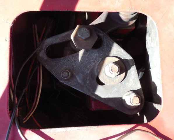

Kurt-NEPA 756 #5 Posted January 31, 2016 To access the friction nut to stop the hydro from slowing down. 1. Lift the seat to access the linkage 2. Adjust the friction by tightening the nut with the big washer under it (in the picture above). Small adjustments can make a huge difference. 3. Test and repeat as needed. BTW, the big nut on top with the bolt in it is a cam that changes the neutral position of the speed lever. Kurt 2 Share this post Link to post Share on other sites
squonk 47,476 #6 Posted January 31, 2016 Those cams wear out also creating lots o slop. That funny lookin plate wears a groove in the cam. look there first! Share this post Link to post Share on other sites

Kurt-NEPA 756 #8 Posted January 31, 2016 The cam plate in the picture I posted above was badly worn, as was the cam. One of the Friction washers was missing too. Needless to say, the motion lever had a multitude of problems. I replaced the cam, cam plate, and friction washers. Adjusted according to the manual and everything worked as it should. Kurt 2 Share this post Link to post Share on other sites
