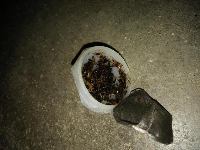

bmsgaffer 2,071 #1 Posted November 6, 2015 (edited) I've been messing with my 520H trying to get it to stop surging without much success. It all started one day before I was about to mow a neighbors yard. The gas shutoff valve was leaking and I thought, "no big deal I have a new one I will replace it so I dont loose any gas in the yard". Famous last words. Well, I did replace it (it had the screen, replaced with one that did not have a screen) and I mowed the yard without loosing a drop of fuel. But as I finished the yard, the surging began. I didn't have a fuel filter in-line. Now I start going two different directions: try to solve surging (whole lots of time spent that I will not go into here) and replace the fuel lines and add fuel filter. Did all that and did not stop the surging but I thought I was good to go. After she sat for a while working on the carb, I tried to fire her up and got nothing. Cranked and cranked... Oh shoot forgot to turn on the gas! So I turn on the gas... Crank and crank. NOTHING! This tractor has less than 400 hours on it!Pulled the fuel line and it was dry, noticed the fuel filter looked a bit odd... cracked open the filter to find It has been on the tractor for less than a few hours of run time! Now the fuel pump is gunked up and the (brand new!) lines are too I think.LESSON LEARNED: CLEAN THE TANK before bothering with the rest of the fuel system.The tank is full of crud. I have to take the whole back end apart AGAIN. Augh. Edited November 7, 2015 by bmsgaffer 3 Share this post Link to post Share on other sites

KC9KAS 4,746 #4 Posted November 6, 2015 How did all that crap get into the fuel tank? 1 Share this post Link to post Share on other sites
DennisThornton 4,773 #5 Posted November 6, 2015 Rinse and blow the tank and the lines, new filter and mow the other neighbors lawn. Won't take you long. It is somewhat of a mystery where all that crap comes from though! 1 Share this post Link to post Share on other sites

bmsgaffer 2,071 #8 Posted November 7, 2015 How did all that crap get into the fuel tank? That is a darn good question! I think the last owner must have left the cap off a couple times. Thanks guys, I know its doable its just frustrating. 2 Share this post Link to post Share on other sites

bmsgaffer 2,071 #10 Posted November 7, 2015 Sorry for my ranting, I just had to get it out. I'm feeling much better now! I did a band aid repair tonight. I put a second fuel filter in right at the tank for any future crud, blew the lines out, disassembled the fuel pump and found the culprit! A few small pieces of the plastic shavings lodged in the pump valves. Cleaned the pump out really well and she fired in two cranks! With all the carb work that had been done thinking that was the problem, she purred better than ever! Idled strong and revved right up. I only had a few minutes to test since it was late and I am trying to respect the neighbors, but I will really test her out tomorrow.I will clean the tank next time I have a chance to take her apart, and hopefully those shavings arent from the tank! but this should do for now. Thanks everyone for the support! I will add a better lesson to my original post:Upon aquiring a new-to-you Onan tractor, under NO circumstances should you run without at least one fuel filter. I will probably forever have two on her. Right after tank and right after pump. 3 Share this post Link to post Share on other sites
