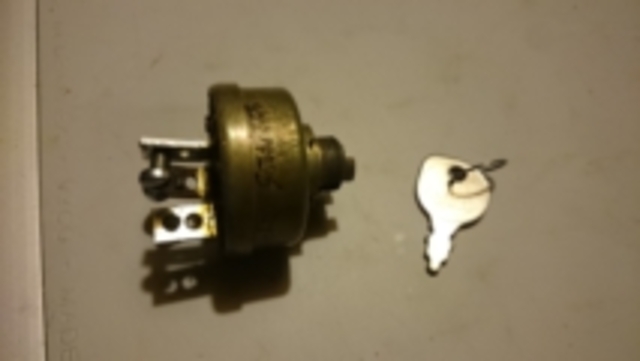

Burnzee 0 #5 Posted November 8, 2015 ThanksLawn Ranger Model 1 2631Yes, I meant ignition switch. I don't think this the original switch but here is a photo of what is had. I have tested it and it is getting power in the starter key position but not in the run position. Share this post Link to post Share on other sites

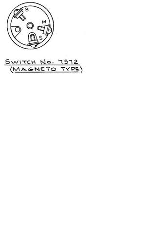

gwest_ca-(File Mod) 12,324 #6 Posted November 8, 2015 You have magneto ignition so the M terminal does not get any power. The magneto is self powered and the ignition switch simply grounds the ignition wire to shut the engine off. Check to see if the M terminal is connected to the switch body (ground) in the OFF position and not connected to anything in the ON position and START position.The 7572 switch has been replaced by 101482 and still available from Toro.Garry Share this post Link to post Share on other sites
Burnzee 0 #7 Posted November 8, 2015 Thanks Garry, I checked and M is grounded to the switch body as you state , so maybe it's OK. Will try to reuse. Can you advise as to the fuse size I should use? is 32 amps ok also that replacement ignition switch number is appreciated. Also need to clean up the carburetor, but that's another story. Share this post Link to post Share on other sites
gwest_ca-(File Mod) 12,324 #8 Posted November 8, 2015 Found the fuse listed in a Tecumseh service manual so added the page with the tractor manuals. Download from therehttp://www.wheelhorseforum.com/files/file/808-tractor-1968-lawn-ranger-da-om-ipl-wiring-snpdf/6 amp - I think the original fuse part number is 29561Garry Share this post Link to post Share on other sites
