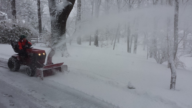

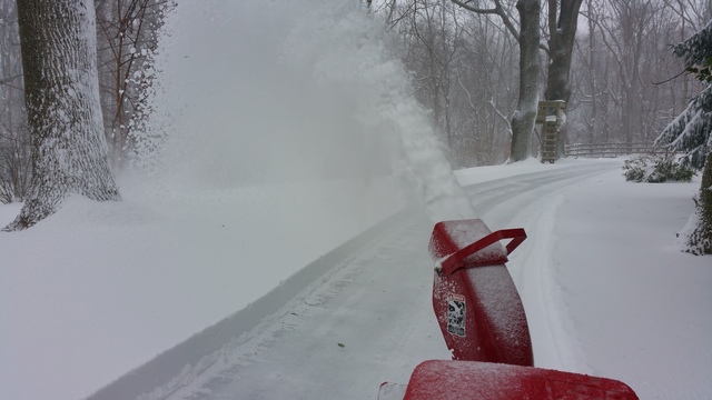

JERSEYHAWG / Glenn 4,589 #29 Posted December 16, 2016 (edited) I am voting with Jeff on the chute guard being better. I bought one for my single stage, took the wire hand guard off. Seemed better. But, from my experience, my chute is smooth, no rust etc, re painted. And I keep it covered, snojet, WD40, spam, wax, etc. BUT, LOW SPEED, HIGH RPMs. Don't forget the single stage needs high revs, works auger and flips snow. High ground speed will overwhelm the snowthrower and clog it everything. SLOW GROUND SPEED, I have had some trial and error seat time, with all kinds of snow. Chain tension good, zerks greased, chain oiled. Hope this helps, best of luck. Glenn Edited December 16, 2016 by JERSEYHAWG / Glenn 2 years ago action shots 2 Share this post Link to post Share on other sites
Duramax7man7 506 #30 Posted December 16, 2016 Yep, Same here.... Max rpm's, slow and steady ground speed for tractor on a Single Stage. I don't even have the tall chute either. Works great. 1 Share this post Link to post Share on other sites
