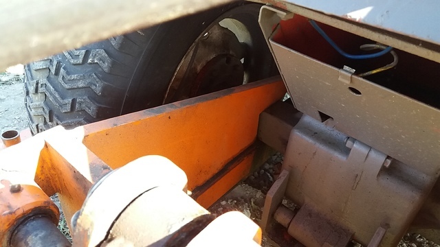

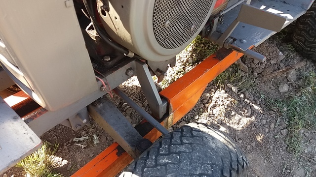

Horse Digger 52 #26 Posted July 16, 2016 (edited) Here trying to capture the quick release feature of the digger. Haven't tried it yet but it seems like one only remove the hydraulic hoses at the pump and release tow pin, then driving the tractor forward away from the digger... Of course, first one have to park the digger rear of the tractor and balance the hight of the platform so no load is on tractor and its not hanging in the air... Edited July 16, 2016 by Horse Digger 4 1 Share this post Link to post Share on other sites

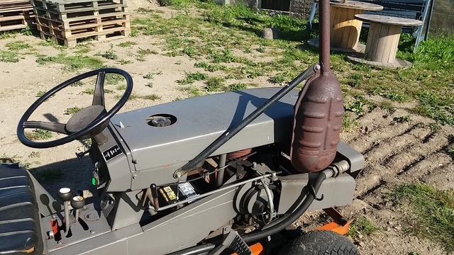

Horse Digger 52 #27 Posted July 16, 2016 (edited) Exhaust and muffler looks modified, but engine noise is comfortably low so I will leave it as is, more or less. Planning to make an U-bend at the end so a used tin can will be useless... Because of the hydraulic pump, the hood cannot be opened more than a couple of inches, therefore a hole is made for filling gas. Checking and filling oil is possible, but spark plug and air filter is not accesable without loosening a bolt or 10... I should make some quick release for the complete hood, anyone done that and want to share it? Edited July 16, 2016 by Horse Digger 4 1 Share this post Link to post Share on other sites

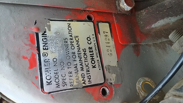

Horse Digger 52 #29 Posted July 17, 2016 (edited) Identification, please... Some erlier owner gave it a bad paint job. Grey Paint with a brush, no need to clean or sand before.... Covering everything that could be reached, even identification plates was included. Trying to remove the paint was succsessful, but text on type-plate was removed aswell... Worked out better om the engine Plate though, but i cannot figure out how to search for it on www.kohlerengines.com, seems like som java error, even if I like coffee... Anyone who can help me, i suspect a engine swap, some bolt-holes look suspicious, will show you later. Edited July 17, 2016 by Horse Digger 1 Share this post Link to post Share on other sites
gwest_ca-(File Mod) 12,454 #30 Posted July 17, 2016 Wheel Horse used the 47421d spec number 1973-1977. If the Kohler serial number is 6244297 it was part of their 1974 production run. It should have ended up on a 1974 or 1975 model tractor. 1974 tractor models 1-0352 1-0353 1-0354 1-0356 1975 tractor models 1-0395 1-0396 Just a guess your's has relatives Garry 2 Share this post Link to post Share on other sites
Horse Digger 52 #31 Posted July 17, 2016 Ok, since mine have range selector the model must be 1-353, presumably from 1974. I'm sorry the identification plate is unable to read though. Earlier I suspected a engine swap since two holes in the oil pan was not used, however i found at the engine section that big block Kohler have alternative fastening and on (some?) WH, the outmost is not used. I'm glad the engine seems to be original or at least original type, and that is is properly mounted. Making plans for a oil change, since I'm not going to use it in winter SAE30 will do, however one oil I found was API CD/SF/GL 1. According to the manual SC is required, can it be that SF fulfills SC (a upgrade) or should I keep looking for SC? Regarding paint, is it possible to buy original WH red, or do I need a recipe and ask my local paint supplier to blend it?NCS or other color number? Share this post Link to post Share on other sites

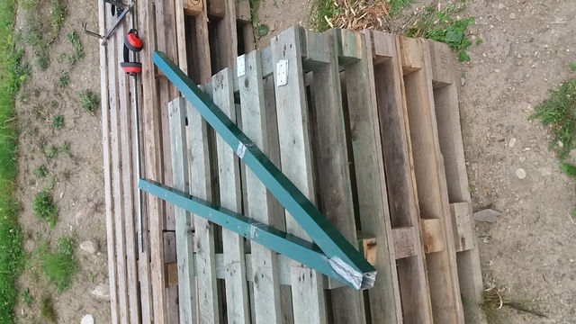

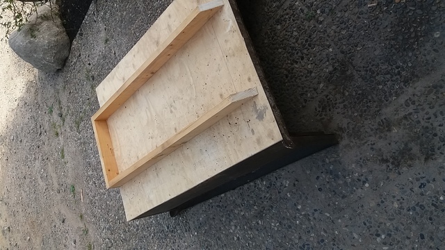

Horse Digger 52 #34 Posted July 19, 2016 (edited) I have a trailer already, but due to overload the tipper feature was disabled. I don't like the function where the wheel axle become tipper axle aswell and have a different idea. A more rigid frame made from 40x40 mm square tube... A plywood plate under the steel bottom will hopefully keep it more flat... Reinforcements under the plate, partly in order to get the space for axle and wheels beneath. Edited July 19, 2016 by Horse Digger 2 Share this post Link to post Share on other sites

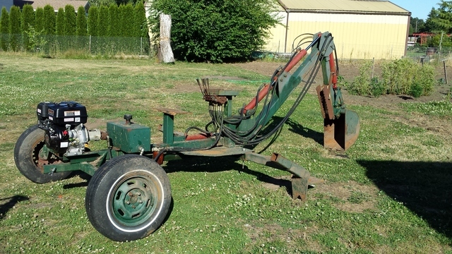

jetmandan 29 #38 Posted July 29, 2016 (edited) 12 hours ago, Horse Digger said: This evening I trained with the digger, big fun but not as easy as it look I can relate to that statement. Recently, a Cad Digger tow-able backhoe followed me home. Was built by a buddy of mine but he lives too far away to come help me, getting used to the controls and making smooth movements is taking longer then I thought it would. Dan Edited July 29, 2016 by jetmandan speeeling 5 Share this post Link to post Share on other sites
Horse Digger 52 #39 Posted July 29, 2016 21 minutes ago, jetmandan said: I can relate to that statement. Recently, a Cad Digger tow-able backhoe followed me home. Was built by a buddy of mine but he lives too far away to come help me, getting used to the controls and making smooth movements is taking longer then I though it would. Dan Impressive work of your friend, is it his (or her) profession to build this things? (But I think mine have a better seat.) I would like a smaller bucket, more like the one on yours. We have a lot of cleat and with a dry summer it's hard as rock... Share this post Link to post Share on other sites
jetmandan 29 #40 Posted July 29, 2016 4 hours ago, Horse Digger said: Impressive work of your friend, is it his (or her) profession to build this things? (But I think mine have a better seat.) I would like a smaller bucket, more like the one on yours. We have a lot of cleat and with a dry summer it's hard as rock... Cad digger builder (Joe) is a retired millwright, he and I both enjoy building our own "toys" (coincidentally, I'm also a millwright). Seat has already been replaced with a garden tractor style one from a grocery store electric shopping cart. Future plans are to add a Wheel Horse hood to protect engine from elements, repaint to a proper IH Red and I have an idea of a sun/rain roof to keep me dry. During summer, our ground turns to something close to the hardness of concrete, a narrower bucket is already coming together. Couple days ago I tried to lift a gas powered welder into a pickup, had power to lift but without any counter weight, I'll I did was raise motor end. Thinking a removable bracket that can hold a 55 gallon plastic barrel for counter weight will take care of that problem. Dan 2 Share this post Link to post Share on other sites

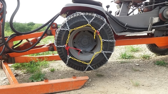

Horse Digger 52 #41 Posted July 29, 2016 According to Google translate millwright is a person building and maintaining mills, didn't know this was such a common profession. 55 gallons, filled with water thats about 400 lbs, right? Are there brakes at the wheels? This too should help, given the wheels touch the ground... Share this post Link to post Share on other sites
jetmandan 29 #42 Posted July 30, 2016 2 hours ago, Horse Digger said: According to Google translate millwright is a person building and maintaining mills, didn't know this was such a common profession. 55 gallons, filled with water thats about 400 lbs, right? Are there brakes at the wheels? This too should help, given the wheels touch the ground... In short a millwright is a fellow who installs, maintains, repairs all the equipment in a company. This is a Wikipedia definition of a millwright, https://en.wikipedia.org/wiki/Millwright I work in a furniture factory with about 400 employees, spend my days keeping all the machines running. Back to the digger, the wheels do not have brakes, the front stabilizers dig in the earth and (mostly) keep me from moving forward while digging. The 55 gallon barrel filled should be close to 500 pounds. If I position it (or one on each side of engine?) that should allow me to use digger as a small crane as well as give me more ballast for breaking hard ground. My machine has more breakout force then its light weight can handle. Do not have any videos of my digger in action but here a few of others who have built same machine. Mini Backhoe CADDigger 728 http://www.dailymotion.com/video/x3m574x https://www.youtube.com/watch?v=lKWt_3Z8Jo4 Looking forward to seeing videos of your Finn Horse!! Dan Share this post Link to post Share on other sites

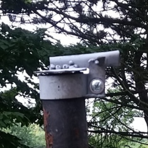

Horse Digger 52 #45 Posted August 10, 2016 (edited) Forgot the tin can and drove to Legoland a couple of days, now I don't have to worry about that anymore... Edited August 10, 2016 by Horse Digger New pic 1 Share this post Link to post Share on other sites

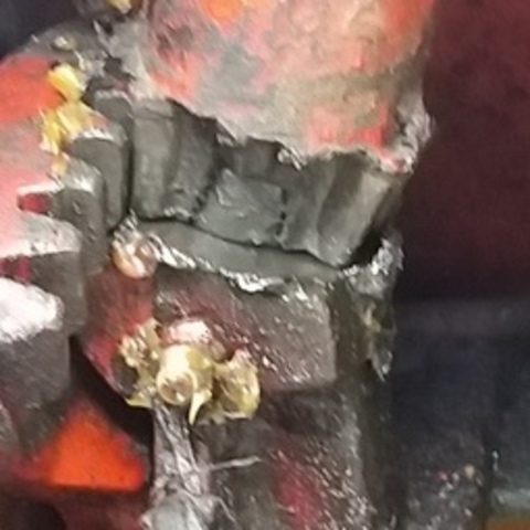

Horse Digger 52 #46 Posted August 10, 2016 Hi, Steering gear, two teeth missing. Finding a used in Sweden seems hard, anyone tried to weld onto the sprocket and axle? Seems like it is welded from start, so it should be possible. I'm thinking of building up new teeth and grinding them to shape. Perfect is hard but just preventing jump over is enough for me... When the digger is on, steering is limited by the digger frame but still jump over is possible at the ends. Share this post Link to post Share on other sites
Lars 526 #47 Posted August 18, 2016 Hello Horse Digger.. btw i was drooling at that when i spotted it on blocket.. ill might have that steering part here in Norway. send me a pm.. 1 Share this post Link to post Share on other sites
Horse Digger 52 #48 Posted September 6, 2016 Ok, Lars have convinced me that I should not attempt to weld new teeth on the steering gear, he just offered me the part to a very favorable price. Thanks again, Lars Btw, the other day I separated the tractor from the digger, pretty easy with just the coupling bolt holding it an quick release om the hoses. However, joining them again will be trickier, trying to align the whole thing.... Share this post Link to post Share on other sites
