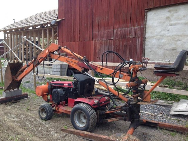

Ian928 47 #1 Posted November 5, 2015 (edited) I just saw this Wheel horse with a really big digger for sale in Sweden! I have never seen anything like this, so I tried to Google but found nothing. I Guess it could be made in Finland (because of the name) or probably sweden. The instruction manual is iin Swedish also.Has anyone seen this before? Lifts the poor tractor right off the ground!Edit, I had a closer look and it states on the instruction manual that it is from Finland, produced by OY KEPPO AB. Edited November 5, 2015 by Ian928 14 2 Share this post Link to post Share on other sites

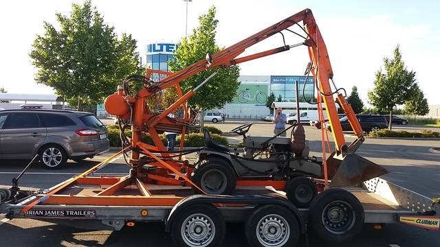

Horse Digger 52 #18 Posted July 15, 2016 (edited) Ok, here we go, from where we brought it home, shopping för a cheep hot dog on a "utility store". 5 SEK for a hot dog, thats about 90 $ cent... Unforturnatley they had stopped serving for the day, but that gave us a opportunity to take a shot or two. .. Edited July 15, 2016 by Horse Digger 7 Share this post Link to post Share on other sites

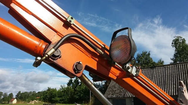

Horse Digger 52 #24 Posted July 16, 2016 (edited) Ok, The front lights was working, otherwise black was ruling, no tail light on the tractor (a loose wire may have to do with that) and certainly no working lights on the digger arm. After some small checking for shortcuts and connecting wires, there where light! Both tail light and working lights are now working, the later turned on at the back of the shell. But, checking the current to the working lights I concluded that using them both, (one on each side) will empty the battery or worse, damaging the alternator. I haven't seen any electric power takeout limit but dragging 10 amp for the working lights only, plus front and tail light (these can only be turned on i combination) I have to limit myself to digging in daylight alt. converting to LED-lamps. Here you also see the well dimensioned hydraulics and joints of the digger... Edited July 18, 2016 by Horse Digger 3 1 Share this post Link to post Share on other sites

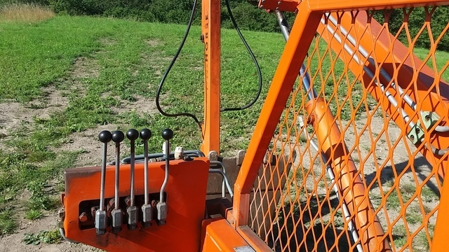

Horse Digger 52 #25 Posted July 16, 2016 (edited) Control panel, Guessing is right now the way to find the right lever and way it should go. Will have to make some icons before digging seriously. You might have seen that this digger is slightly different to the one who originally started the thread. Seat and controls are moved alongside the arm instead of behind, providing a better view and easier entry for the operator. (might be a quote from an updated sales manual...) Also the platform structure is different, where the "older" version had one circular tube between the two beams and mine "improved" version have 4 rectangular tubes in form of an X. However the X was welded with reinforcements, telling me it should be even stronger from start... Edited July 16, 2016 by Horse Digger 3 1 Share this post Link to post Share on other sites
