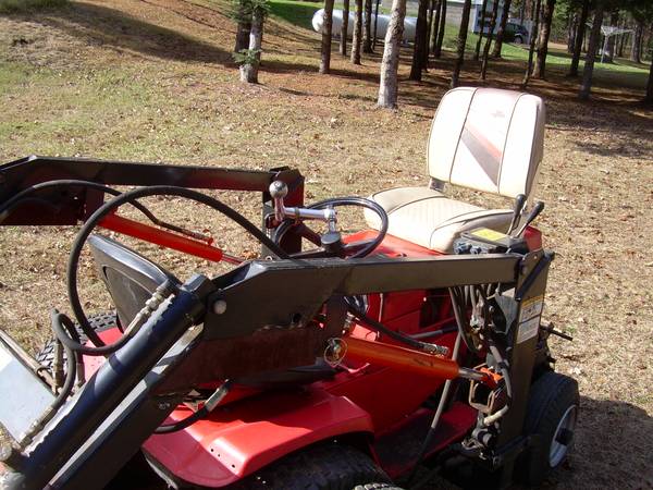

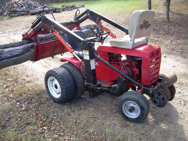

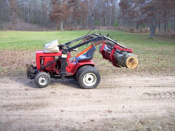

Lost Pup 187 #1 Posted November 4, 2015 Saw this on craiglist today. I copied the pics , i can not say i have ever seen this done. Mounting the loader backwards then fabbing a grapple with snow blades. Heres some of the pics. 5 Share this post Link to post Share on other sites

953 nut 67,376 #4 Posted November 4, 2015 That is quite the logging rig, I don't think I would want to spend too much time in the Hot Seat over the engine; gives a whole new meaning to nut roaster. 4 Share this post Link to post Share on other sites
Pullstart 70,679 #5 Posted November 4, 2015 Yeah, that boat seat is something else. Imagine the wheelies that thing could do! Share this post Link to post Share on other sites

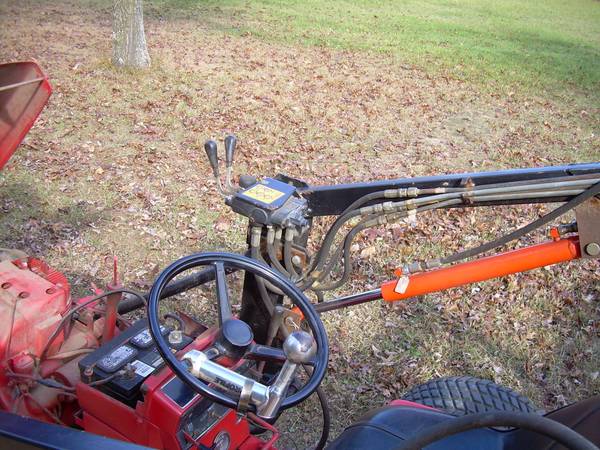

DougC 2,644 #7 Posted November 4, 2015 The 3rd picture shows the hitch ball he installed so he can pull the trailer he made out of the rear half of his ex-wifes rusty 1968 Ford 1/2 ton pickup truck with the bullet holes in the side................ Share this post Link to post Share on other sites

WHX?? 57,384 #10 Posted November 4, 2015 Really ...how bizarre...that ain't exactly a tooth pick it's haulin either ... if it works what the heck. Would be awesome for makin firewood.Whats the thing on the steering wheel for ...some kind of suicide knob??? Share this post Link to post Share on other sites
cheesegrader 436 #11 Posted November 4, 2015 That is a classic example of the "before" picture of a catastrophic failure.The loader is overloaded. He is using the dual rears to try to handle the overload.Looks like a front wheelie waiting to happen.If he adds enough weight to prevent the wheelie, he is going to crack the frame immediately in front of the subframe attachment.I would not buy that thing at any price.Bad idea, poorly executed. 1 Share this post Link to post Share on other sites

boovuc 1,090 #15 Posted November 5, 2015 Well at least the rear-facing seat folds down so you can see driving forward. Or is that reverse? Oh and this thing will snap. Might be next week. Might be next year but hauling logs like that.............oh yea! It's going to snap somewhere! Share this post Link to post Share on other sites
Forest Road 595 #16 Posted November 5, 2015 I'm half tempted to try it on my Xi. Biggest problem I have is traction once the bucket is loaded. This just puts the weight where it'll be most effective. Although I'm not sold on the clamshell. Think I'll stick to dragging my logs. Sent from my iPhone using Tapatalk Share this post Link to post Share on other sites

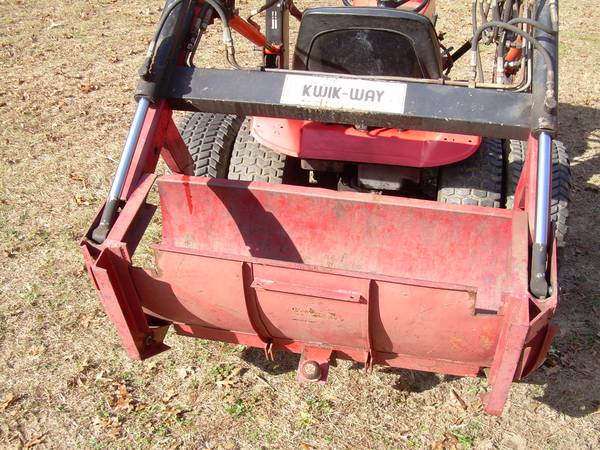

WNYPCRepair 1,924 #17 Posted November 5, 2015 I don't get why he didn't just put the grapple on the front, unless it was for traction, like Forest Road said. The other thing I don't get is why the two plow blades? He fabricated the framework around the blades, why not just fabricate a real grapple? Share this post Link to post Share on other sites

WHX?? 57,384 #20 Posted November 5, 2015 Think I'll stick to dragging my logs. Sent from my iPhone using Tapatalk Thats what I do Forest, problem is here when I drag they pick up sand & dirt and that can get rough with the chain & lumber saws. Still for that kinda coin one can find a bigger tractor with a FEL and use chains & slings. That is a classic example of the "before" picture of a catastrophic failure.The loader is overloaded. He is using the dual rears to try to handle the overload.Looks like a front wheelie waiting to happen.If he adds enough weight to prevent the wheelie, he is going to crack the frame immediately in front of the subframe attachment.I would not buy that thing at any price.Bad idea, poorly executed. Surely overloading the axle. Note the left rear outboard tire sagging, either overloaded, uninflated or both! Share this post Link to post Share on other sites
