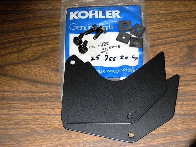

@shallowwatersailor
" Kohler does sell an access panel kit that you can install to gain access for cleaning without removing the engine. It needs to come out though to install the kit"
I've searched for the kit with no luck, you don't happen to have a link, do you?
shallowwatersailor
Here is the link for the accessories catalog. The correct name is "Blower Housing Clean Out Panels" and are on page 18. Part # 25 755 20-S
http://www.kohlerengines.com/accessories/landing.htm
Kohler made it a bit difficult as there are internal baffles within the Blower Housing. Here is a photo of an engine with them installed and the panels themselves. A template to cut the hole is included.

WNYPCRepair
Ordered, thanks. $15 plus shipping.

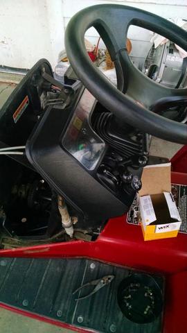

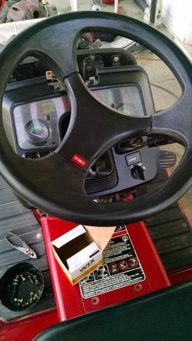

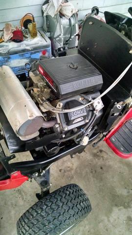

Got the motor back in today and it started right up but found a oil leak coming from the oil filter went ahead and changed the oil and filter it needed it anyway and also changed the trans filter put a WIX on it and through away the fram filter also put a new fuel filter on it too i'm glad to report that it is running good just need to finish cleaning the rest of the side panels and screens and it will be time to move on to the deck witch needs a new belt put on it and a little bit of welding done to one of the hangers

What is behind there? Is it safe to cut them on the engine, or do you need to pull the engine to install them?
Brian01
Access panels seems to me, that wouldn't help much, and a pain to put on. Looks to me like you couldn't really get to much,  just being able to open up the ends. :twocents-02cents:

I think they would help so you can take the water hose or air blower to it but if you really want to get it good and clean i would think you still need to pull the whole cover off but i could be wrong and i know its a pain to pull the whole engine but i was able to get it clean and give everything a good inspection

I bought those access  panels last year, never pulled the motor, the mord I look at it and study it I am starting to wonder if its worth it or not. Like posted before me,,what can yoh actually get to? I wish there was a better idea cause I bet I have a ton of minute grass clippings in there. Dam man ..

Panels are easy as they sit on the ridge of the blower housing. I used thumb screws with hex heads. The problem is the left cylinder from the driver's seat. There is a baffle in the way that blocks access from the top. It gets the airflow first so all of the fine particles collect there, especially if it is oily. The access panel allows you go straight in.
The Simplicity Legacy is even worse. The engine HAS to come out because the back is right up against the firewall.
