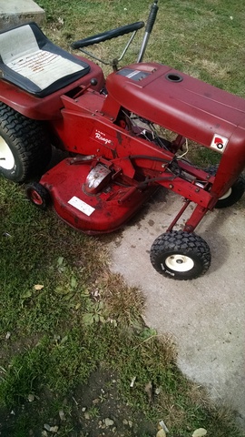

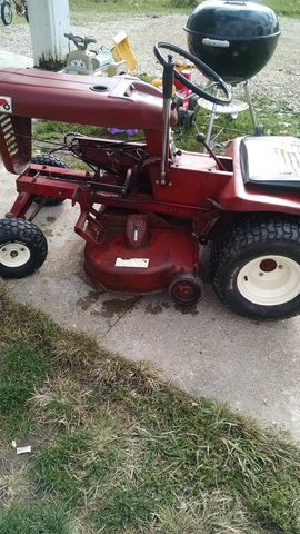

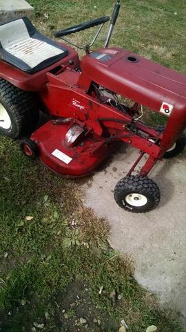

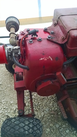

slammer302 2,157 #1 Posted November 3, 2015 I thought i would share my little lawn ranger winter project with you guys i bought this little guy over the summer and haven't did much with it besides give it a good cleaning it ran when i got it but smoked a little and was had to start and the more i used it the worse it got i think it is a combination of things so the plan is to focus on the engine wont really know how bad it is till i tear into it i will keep you posted. 5 Share this post Link to post Share on other sites

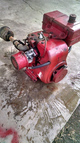

slammer302 2,157 #6 Posted November 3, 2015 Started taking the motor apart today here's what I got to work with. Found a set of rings on eBay for pretty cheap I will probably order them Sent from my XT1080 using Tapatalk 1 Share this post Link to post Share on other sites

slammer302 2,157 #11 Posted November 22, 2015 I found a nice hh60 on CL going to look at in a few min if it checks out it will be for the lawn ranger the price is 125$ not sure if its a good deal or not but seems easier then a full rebuild 2 Share this post Link to post Share on other sites
Brian01 481 #12 Posted November 22, 2015 Nice, I seen that on CL, IMHO, worth every penny. Heck I sale parts engines that don't run all the time for $75-140 Share this post Link to post Share on other sites

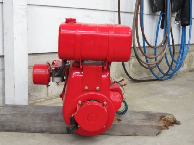

Terry M-(Moderator) 2,329 #13 Posted November 22, 2015 2 hours ago, slammer302 said: I found a nice hh60 on CL going to look at in a few min if it checks out it will be for the lawn ranger the price is 125$ not sure if its a good deal or not but seems easier then a full rebuild Slammer, Just a heads up....HH60's make nice replacements for the H60. But, an HH60 from a troy built tiller(like what you have pictured) is slightly different when it comes to the oil level in these engines. A few I've found, have a "slightly modified or different oil dipper and all of them I've seen have a different length dip stick because of the way these engines are mounted on the tillers. What I mean is on a troy built tiller , the engine mounts slightly back with the output side of the crank pointed more downward. Nothing wrong with that but looks like tecumseh did these changes to accommodate the design on these tillers. worth checking out....mostly though, you may need to just find a correct length dipstick if you choose to use this engine. I,ve taken many of these apart, so i'm just giving you my 2 cents. The dipsticks are numbered, but off the top of my head I can't remember what they are. 1 Share this post Link to post Share on other sites
jimkemp 533 #14 Posted November 22, 2015 The HH60 is the motor I was looking for my 656 , at that price I would grab it and if you end up not wanting it let me know and I would like it for my tractor 1 Share this post Link to post Share on other sites
slammer302 2,157 #15 Posted November 23, 2015 Looks like the motor is a newer short block has a tag on it that says SBH just got home with it Share this post Link to post Share on other sites
Brian01 481 #16 Posted November 23, 2015 Cool, aint mounted and cruisin' in the yard yet!? lol Share this post Link to post Share on other sites
Terry M-(Moderator) 2,329 #17 Posted November 23, 2015 36 minutes ago, slammer302 said: Looks like the motor is a newer short block has a tag on it that says SBH just got home with it I thought SBH = short block horizontal shaft.... Share this post Link to post Share on other sites

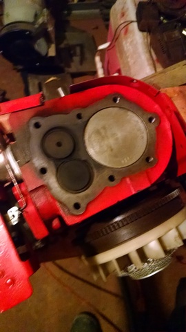

slammer302 2,157 #19 Posted November 23, 2015 I pulled the head off to see what it looked like inside and noticed lots of oil around the intake valve and took the air filter off and it was full of oil I guess someone ran the crank case breather hose into the air filter housing and teckys love to blow oil out the breather when over full on oil so hope removing the hose will fix it Share this post Link to post Share on other sites
slammer302 2,157 #20 Posted November 24, 2015 Got the motor back together and mounted on the lawn ranger and it runs great no smoke I think its going to work well still waiting on my crank shaft sleeve to show up. 4 Share this post Link to post Share on other sites
Brian01 481 #21 Posted November 25, 2015 You use the old front engine Tin? I want an ol lawn ranger so bad... Share this post Link to post Share on other sites
slammer302 2,157 #22 Posted November 25, 2015 Yes I used the old engine shroud the one that came on the new engine was different it didn't have the holes in it for the gas line and also had two holes in the front of it for the side ways gas tank mount plus I just like the look of the original one Share this post Link to post Share on other sites
