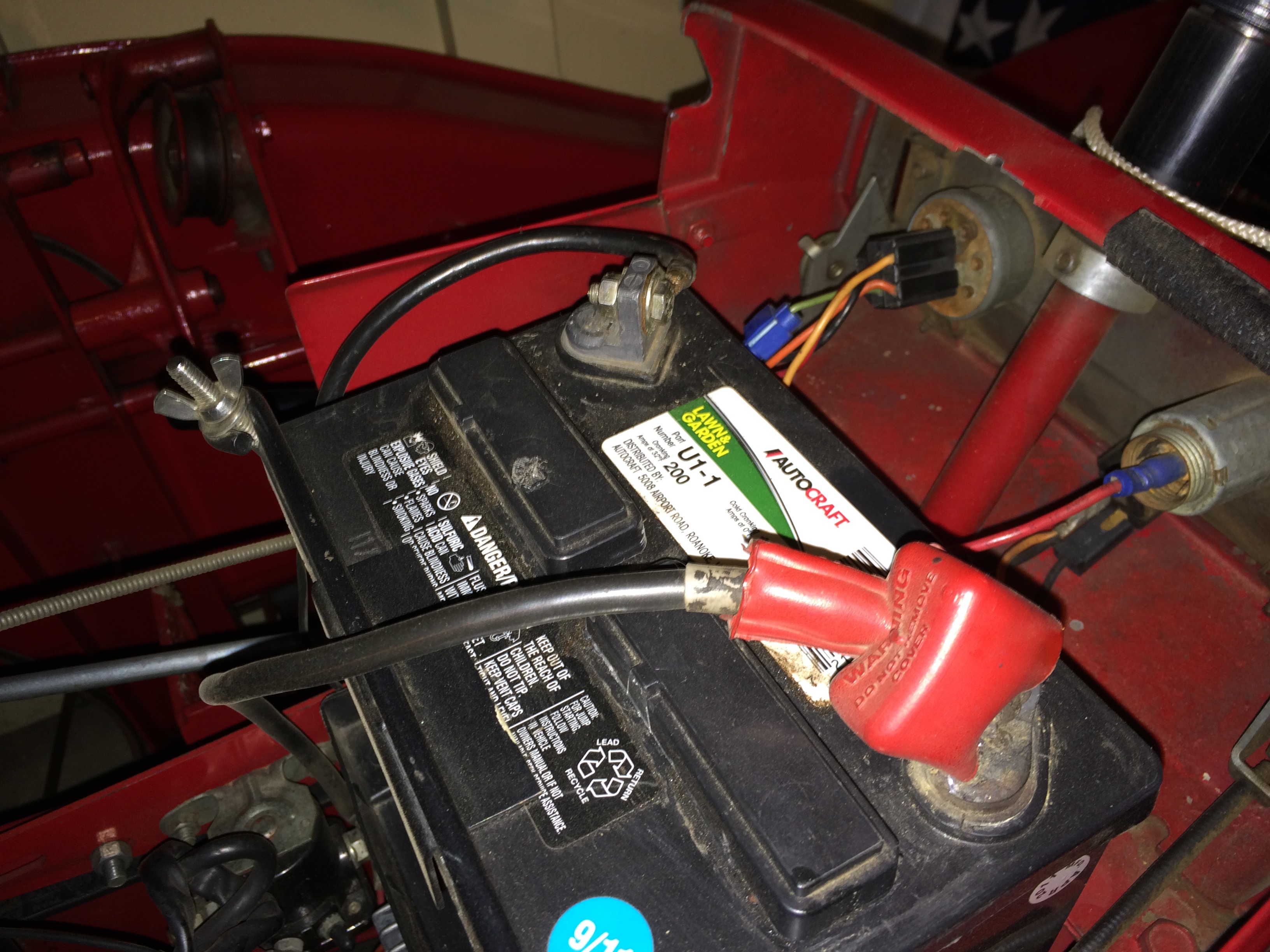

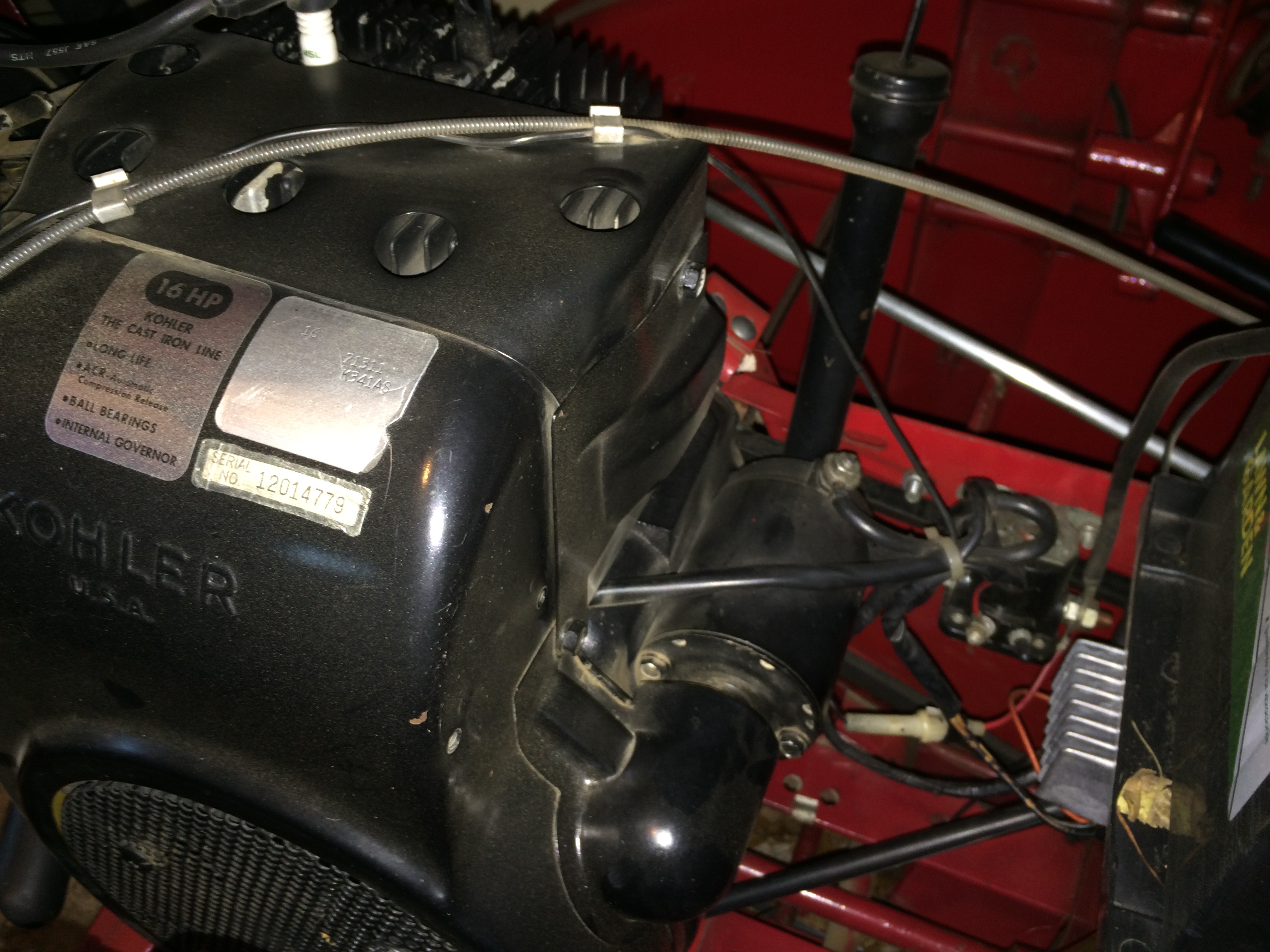

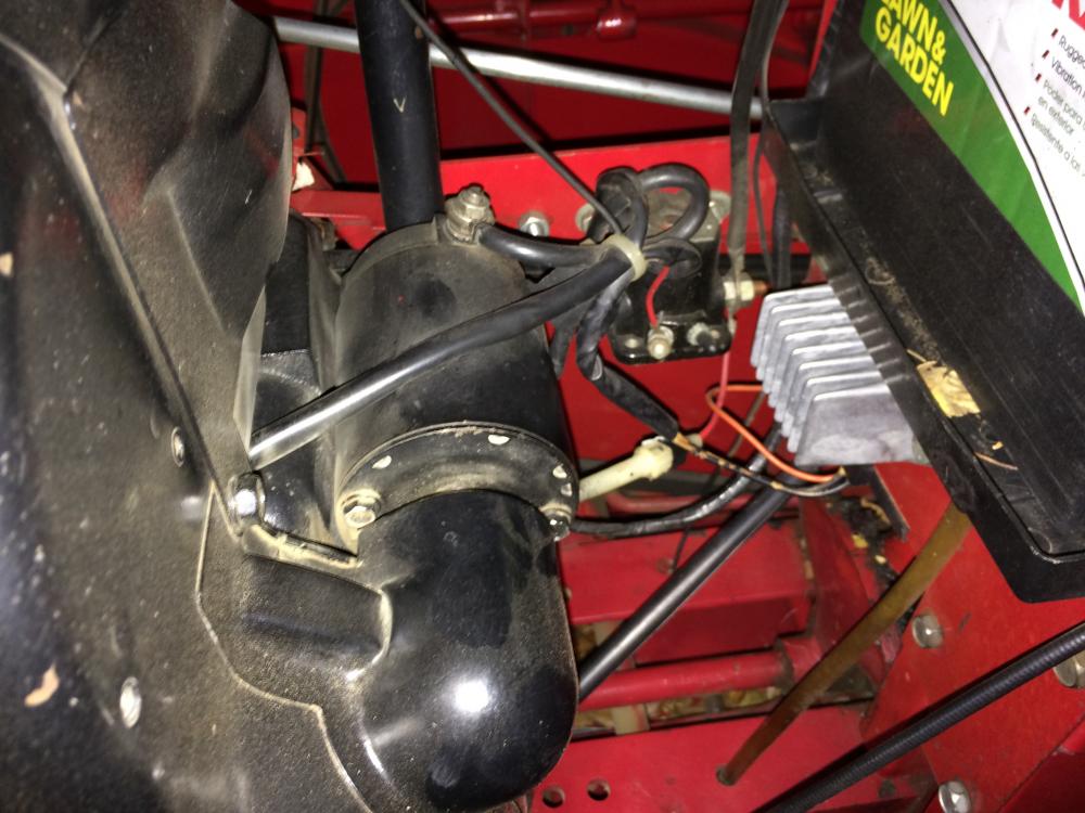

Al C. 1,474 #1 Posted November 2, 2015 Yesterday I was using my SK-486 to clean up the yard. It runs great. I turned it off for a minute to pick up some debris. When I got back on and turned the key, nothing happened. I thought it might be the battery, so I jumped it. Again, nothing. There is no indication that the starter is getting any juice. I've never had difficulty starting before. The lights and hour-clock are working fine. I'm thinking the starter crapped-out. Any thoughts on how I can better troubleshoot before I invest in a new starter? Appreciate everyone ideas. Pictures attached. 3 Share this post Link to post Share on other sites

squonk 48,039 #4 Posted November 2, 2015 (edited) first thing I would check is the ammeter if it has one. another thing, looking at your pics, that neg cable on the battery looks like it has seen better days and looks like the end is stressed from being too short. Also check that added on fuse holder. I have seen those springs inside them fail Edited November 2, 2015 by squonk 1 Share this post Link to post Share on other sites

DennisThornton 4,773 #6 Posted November 2, 2015 First thing i usually do is make sure it's in neutral and jump from the positive terminal to the small red wire on the solenoid. Very clearly shown in your photo. If the solenoid engages and the starter turns then it's in the wiring in front of the solenoid. But I still say download your wiring diagram. 2 Share this post Link to post Share on other sites

Al C. 1,474 #10 Posted November 2, 2015 Dennis, I jumped the positive battery terminal to the red wire on the starter ... there is life in that starter !!!! Now I'm working backwards from there. I'll let you all know what I find. Thanks !!! I found the problem - PTO interlock. I had the mower attachment engage while I was trying to start. Ok, guys ... I deserve my fair share of ribbing. I've never before turned off the tractor before disengaging the mower (I was in a hurry) and it didn't dawn on me to check it. Thank you for all your help. It is unbelievable the support that exists through the members on this site. 3 Share this post Link to post Share on other sites

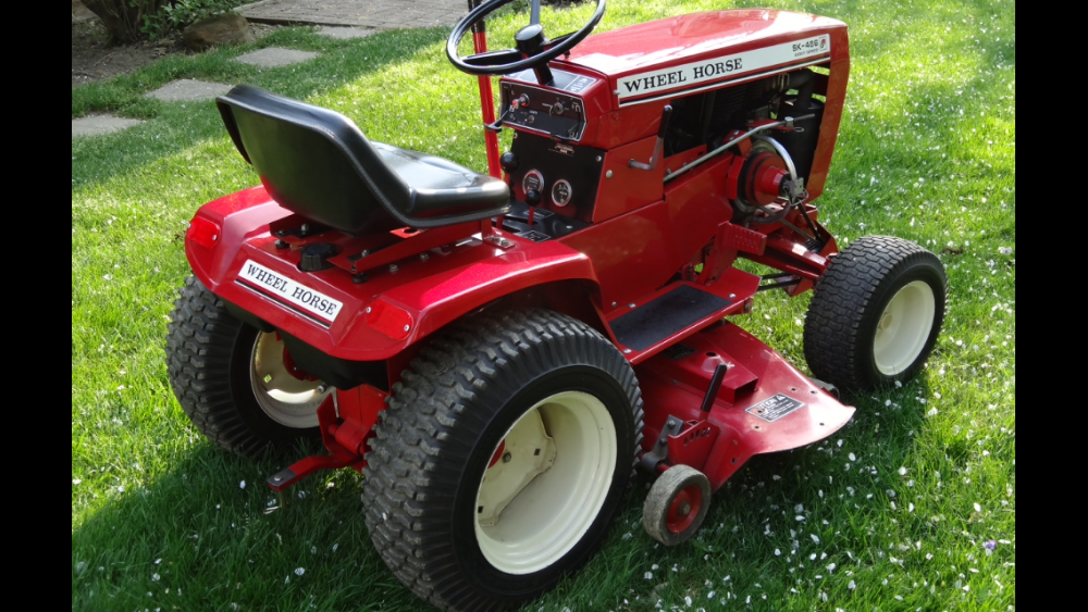

857 horse 2,588 #17 Posted November 2, 2015 Most likely there is nothing wrong with AI C 's tractor....What i think is happening is....He just found this W/H still in the factory box...He just opened the box...and is showing off his very verynice looking machine.....this is his way of saying...."Hey guys,,,,lookie at what i found ""Very nice....Your pics make me want to go out and give all my machines a nice bath..........Lookin good !!!!!! keep it up 2 Share this post Link to post Share on other sites
