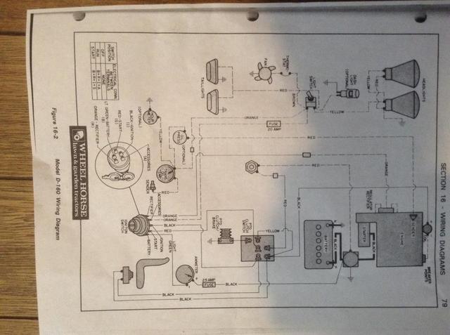

Sea-Duck51 55 #1 Posted November 1, 2015 (edited) Ive been trying to sort out a fuel problem and while figuring that out the horse went dead,after shutting it off and trying to restart have no power to anything except the positive side of Amp Meter,has a new key switch installed before this problem,changed the solenoid and will crank if jumped so it's good,after studying the wiring schematic decided to pull the light green wire off - side of amp meter,ran a jumper from battery to it and turned key switch to start and it worked,would start,now my question is the amp meter shorted out or am I bypassing the PTO switch which I know could keep it from starting,dazed and confused after tracing all the wires,fuses,grounds so any help is greatly appreciated,the seat safety switch was/Has been jumped and not the issue,it's been that way forever so not a issue,thx Edited November 1, 2015 by Sea-Duck51 add info 1 Share this post Link to post Share on other sites
gwest_ca-(File Mod) 12,324 #2 Posted November 1, 2015 Sounds like the ammeter has failed. Take one of the wires off and mount it on the other stud and wire. Remove the fuse first so the sparks don't fly but don't forget to plug it back in after you have the wires joined.Rather than replace the ammeter with another I would add a voltmeter as they tell you more and cheaper to obtain as a rule. If you do switch make the above connection permanent and power the voltmeter by the ignition circuit and a ground. That way it is off with the ignition off.Garry Share this post Link to post Share on other sites

gwest_ca-(File Mod) 12,324 #5 Posted November 1, 2015 Someone will correct me if I'm wrong. This is how I think an ammeter works.Between the 2 terminals is a low value resistor. Most of the current flows through that resistor. The meter is actually a voltmeter that is measuring the voltage drop across the resistor. If the voltage on both sides is the same no current will flow through the resistor so 0 amps is displayed. If the voltage on one side is higher than the other current will flow and depending on how much and which way displays a + or - amp reading.That resistor between the posts may be cracked.Garry Share this post Link to post Share on other sites
