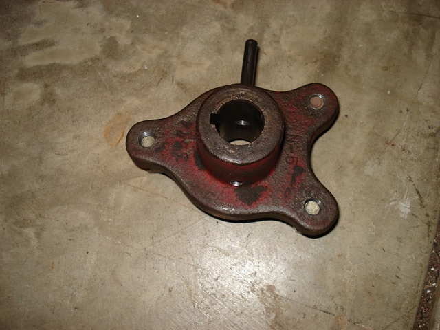

Achto 32,131 #1 Posted November 1, 2015 Hi every one, I have an idea that I wanted to bounce off you guys. I started taking the tranny apart on my Suburban 400 and found that the axle and hub key way are wore. My idea is to cut key way whole length of the exposed part of the axle and use a square key the same width as the hub. I also would drill and tap a set screw hole in the hub over the key way. (Not sure why they didn't place a set screw there from the factory). My thought is this would allow the good part of the key way in the hub to be utilized. Anyone think this will work or would it be a wast of time? 1 Share this post Link to post Share on other sites

953 nut 67,644 #8 Posted November 3, 2015 The only rational reason for the set screw not having been placed over the key would be that it is the thinnest, and therefor the weakest point on the casting. You may want to drill a shallow hole in the axle under the set screw too. 3 Share this post Link to post Share on other sites
bean 85 #9 Posted November 3, 2015 I had an axle that was worn and did a simpler fix. I drilled a 3/8" hole through the hub and axle and used a 3/8" drift pin. it worked fine, but was a low hp tractor. I wouldn't try it with a 4-16 with 26x12x12 tires 1 Share this post Link to post Share on other sites
stevasaurus 23,763 #10 Posted November 3, 2015 Looks like Bean's is #3574...I'm guessing his set screw hole is over the key. Share this post Link to post Share on other sites
Racinbob 13,054 #11 Posted November 3, 2015 The 3 hole hubs on my 400 are stamped 3574 and the set screw is about 90 off the key. The other pair I have with the set screw on the key don't have a number on them. 1 Share this post Link to post Share on other sites
bean 85 #12 Posted November 3, 2015 I had a set of suburban hubs on my rj and the set screw wasn't over the shaft keythe hub in the pic is from an 854I think wheel horse got away from the suburban style hub quickly, because it had a tendency to move on the shaft 1 Share this post Link to post Share on other sites
Racinbob 13,054 #13 Posted November 3, 2015 (edited) That's interesting bean but probably not original to the 854. They had 5 lugs. Knowing that most all of the cast parts back then has numbers I just now took a scrub brush to the 3 lug hubs that I said didn't have a number. Sure enough, I was able to make out the number. Another pair of 3574 hubs. So there you have it. Two pairs of hubs marked 3574, one with the set screw on the key way, one with it about 90 off. More Wheel Horse inconsistency. This really didn't surprise me. Over the years I've seen many parts that were designed different but had the same number on them. Often the difference was more than just a set screw hole relocated.The second set of 3574's were on one of the tractors recently given to me. The other had 5 lug hubs. The tractors are a 657 and a 500 Special. According to the original parts list both should have 5 lug hubs Obviously switched out. Edited November 3, 2015 by Racinbob 1 Share this post Link to post Share on other sites
