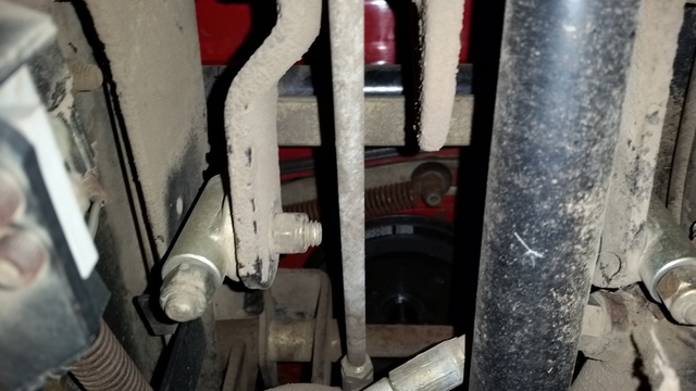

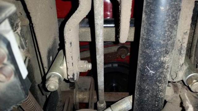

Xearl 132 #1 Posted October 31, 2015 I have yet to find any information on adjusting these . xearl Share this post Link to post Share on other sites
gwest_ca-(File Mod) 12,533 #2 Posted October 31, 2015 What is it?Anything in the service manual?http://www.wheelhorseforum.com/files/file/3331-tractor-2000-5-xi-tractor-sm-492-4715pdf/Garry Share this post Link to post Share on other sites
Xearl 132 #3 Posted November 1, 2015 Thanks but as far as I can see it is not in these . xearl Share this post Link to post Share on other sites
WNYPCRepair 1,924 #4 Posted November 1, 2015 I'm with Gwest, what are we looking at? Share this post Link to post Share on other sites

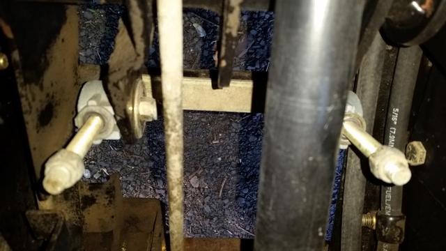

shallowwatersailor 3,222 #5 Posted November 1, 2015 (edited) That is the lift mechanism for the mower deck, I believe. The first shot is looking up, and the second shot is down through the access panel.Why do you need to adjust them? Are they lifting the deck too much, or are you trying to attach a snowplow. If it is the plow, the arms get pinned in the up position so that only the rockshaft rotates. Edited November 1, 2015 by shallowwatersailor Share this post Link to post Share on other sites

Xearl 132 #9 Posted November 2, 2015 None of the manuals have anything about these . From the very first when I got my 518xi I put a snow blade on it . To me it seemed that it did not lift high enough ,maybe 3 inches at the most .Now I have a 523DXI with a snow blower on it and the same thing . I tried going into my shop which has a 3 inch lip and it hit . I would like to be able to raise the blade or the blower enough to clear . I would go on except typing is not my thing . One finger . Thanks for all the input . ED Share this post Link to post Share on other sites
shallowwatersailor 3,222 #10 Posted November 2, 2015 Have you used clevis pins to "pin" the lift arms up? They are not used to lift the snowblower or plow. The silver rods connect to the lift arms which are used only to lift the mower decks.. The lift system is hydraulic without any adjustment but are you using the correct hole in the Attachment Lift Plate? The plow does raise only about three inches using the slotted lift link. I don't have the solid lift link so I don't know if it lifts higher. I have a single stage snowthrower that must raise about five inches at the rear.Try pumping the front tires up to 20 psi. The '98 manual says 12 psi but later years state 20 psi. Share this post Link to post Share on other sites
Xearl 132 #11 Posted November 2, 2015 Yes The pins were in when I got the 523Dxi but I never knew about them before . I never had them in on the 518 with the plow. I'll see how it works out . Thanks for the heads up on the tire pressure . ED Share this post Link to post Share on other sites

Dennys502 246 #16 Posted November 4, 2015 To Adjust the lift arms - start the engine and pull up on the lift lever until the lift arms are all the way up. Then tighten the nuts until the lift arms are tight against the footrest support. This is for all models - doesn't matter what attachment. 2 Share this post Link to post Share on other sites
Xearl 132 #17 Posted November 4, 2015 Thank you Denny . I have never found any information anywhere for this adjustment . ED Share this post Link to post Share on other sites
Dennys502 246 #18 Posted November 4, 2015 You are welcome Ed. Glad I could help. I looked around and could find nothing either. This should have been in the initial setup manual and in every attachment manual. Looks like Tech Pubs missed it and whoever reviewed the manuals did also. Share this post Link to post Share on other sites

RMCIII 840 #20 Posted November 10, 2015 Denny is right, but what allows it to adjust up or down is the out of round cylinder that is between the 2 arrows in his photo.RC Share this post Link to post Share on other sites
Xearl 132 #21 Posted November 10, 2015 RC , Thanks for the info . Between the two adjustments I'm hoping to get a little more lift . ED Share this post Link to post Share on other sites
shallowwatersailor 3,222 #22 Posted November 10, 2015 Denny is right, but what allows it to adjust up or down is the out of round cylinder that is between the 2 arrows in his photo.RC Rob, those are for adjusting the blade slope for transport on a mower deck. 1 Share this post Link to post Share on other sites
RMCIII 840 #23 Posted November 10, 2015 Denny is right, but what allows it to adjust up or down is the out of round cylinder that is between the 2 arrows in his photo.RC Rob, those are for adjusting the blade slope for transport on a mower deck. Correct, which levels the deck also. So if one cam is off center and the other is on center, his lift arms will not come all the way up to the floor board supports.RC Share this post Link to post Share on other sites
shallowwatersailor 3,222 #24 Posted November 10, 2015 Denny is right, but what allows it to adjust up or down is the out of round cylinder that is between the 2 arrows in his photo.RC Rob, those are for adjusting the blade slope for transport on a mower deck. Correct, which levels the deck also. So if one cam is off center and the other is on center, his lift arms will not come all the way up to the floor board supports.RC Rob, his problem is with the snowplow not the mower deck. These are pinned to the chassis in one position when using the plow. Share this post Link to post Share on other sites
