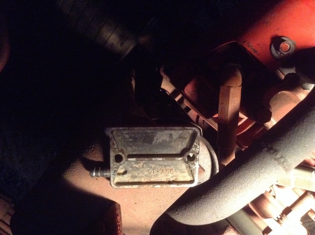

Sea-Duck51 55 #1 Posted October 31, 2015 I believe the fuel pump,not attached to carb may be bad or in need of repair,was thinking about converting to a low pressure 2-4 psi 12 volt pump,has anyone have input,knowledge or done this,thx for your help. Share this post Link to post Share on other sites

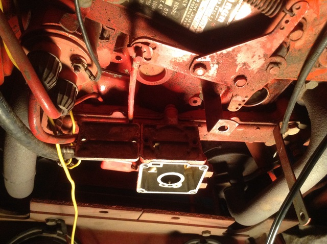

Sea-Duck51 55 #3 Posted October 31, 2015 Thanks for the useful info but turns out pump is not the problem,cleaned tank,shutoff valve,new fuel lines,filter,cranked over and plenty of fuel so decided to take top off carb and side plate,bowl was half full but here's my question,fuel come in the bottom chamber and must work its way to top chamber and into float bowl but it seems since there both the same it appears the only way is the thickness of gasket which is thin,it ran before but only on 3/4+ choke,acts like its starving for fuel,any thoughts gentleman?. Share this post Link to post Share on other sites
Sea-Duck51 55 #4 Posted November 1, 2015 I figured out the gasket,rubber type material was too thin or squeezed too tight so with some gasket material made two more for a total of three which allows more clearance for the fuel to reach the upper chamber thus getting into the bowl,runs like a champ and throttle is responding,only need the choke to start now instead of running on it. Share this post Link to post Share on other sites
