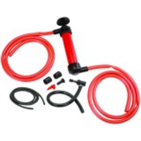

slammer302 2,157 #2 Posted October 28, 2015 A tire shop that deals in farm equipment tires can fill them for you. I bought one of these transfer pumps at walmart to empty a gas tank and i read a post that they can be used to fill tires i am planning on trying it i think its going to be the cheapest route there is not alot of people selling wheel weights for cheap but you may get lucky if your patient 1 Share this post Link to post Share on other sites

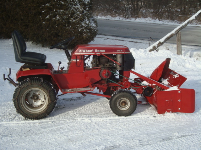

Row Cropper 63 #8 Posted February 2, 2016 Brian, If you are still interested in weights, I have a pair of solid steel weights that are 68# each, I will sell them for $160 for the pair. I see you are in W. Central Ohio, so for full price I will bring them to Columbus and meet you there to save the shipping. I am near Dayton and we get to Columbus pretty often so this will make the cost more reasonable for you. I have attached a photo showing them on one of my tractors. Let me know if interested! 2 Share this post Link to post Share on other sites
