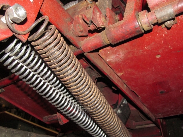

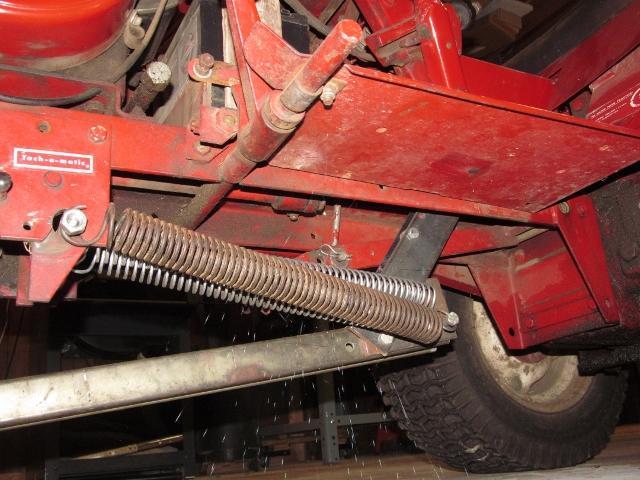

ronhatch 410 #14 Posted November 2, 2015 (edited) Please note the lift assist springs right behind the front axle that I installed on my snow plow. Also as previously mentioned, attach your lift linkage in the nearest hole to the lift cross/rock shaft. Edited November 2, 2015 by ronhatch 2 Share this post Link to post Share on other sites
Brian01 481 #15 Posted November 2, 2015 I like them back wheels. 3 Share this post Link to post Share on other sites
elcamino/wheelhorse 9,363 #16 Posted November 2, 2015 Ron , I like that idea what kind of springs did you use? Also like the tractor . Is that your 857? 1 Share this post Link to post Share on other sites
