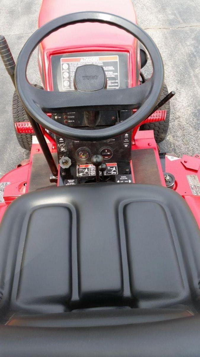

JimD 3,347 #2 Posted October 26, 2015 If it's an 8 speed transmission it might be in the low range.Does it have two shifters? If so the lower one is the Hi Low range selector. Shift it to the right to get back into Hi range which will speed up all the gears. 4 Share this post Link to post Share on other sites

stevasaurus 23,816 #6 Posted October 26, 2015 I borrowed this picture from Colbyeast in the gallery. You can see the 2 shifters next to each other. The smaller one is a hi/low shifter, the other one (as you know) gives you the 3 gears forward and l1 in reverse. 2 Share this post Link to post Share on other sites

stevasaurus 23,816 #9 Posted October 26, 2015 Well....that changes things a little. Glad we started a thread now?? Now it sounds like your shifter. Does it feel like you are changing gears when you move the shifter?? Check out that hi/low thing when you get home also. It would be nice to know if that works while we are at it. Let's see what you find. 3 Share this post Link to post Share on other sites
