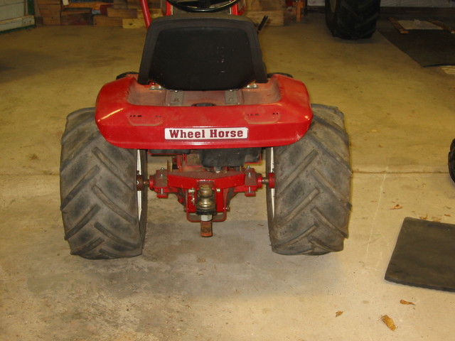

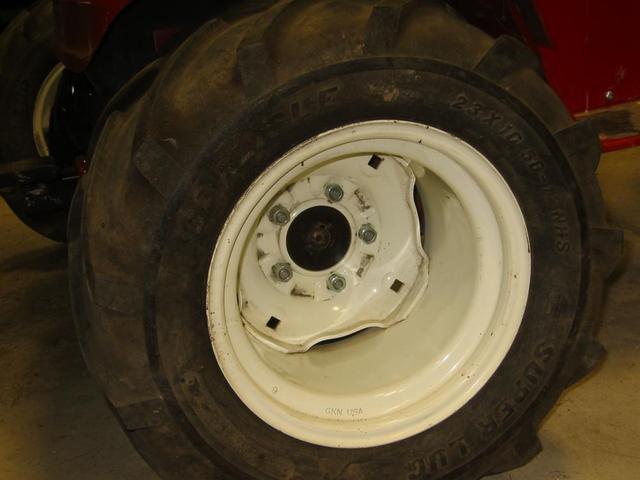

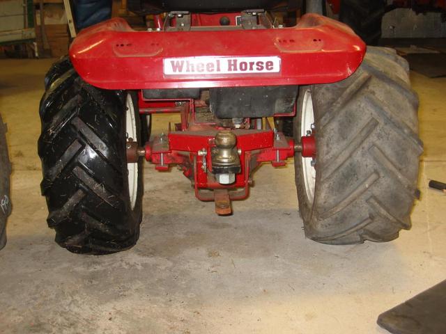

pfrederi 21,306 #1 Posted October 25, 2015 Picked up a pair of mounted used Ag tires at an auction yesterday. They are Carlisle Super lugs 23 10.50x12 mounted on 8.5" rims. Put them on my 310-8 (she is my pulling tractor...that is trailers and other stuff not competition). She had Deestone Super extra grip 23 10.50x12 on WH 7.5" rims. Look at the difference. Wish I knew where the 8.5" rims came from as the backset is perfect for WHs...By the way Bob Maynards Studs and lug nut set made swap a breeze 10 Share this post Link to post Share on other sites

857 horse 2,588 #3 Posted October 25, 2015 That looks.....just mean !!!!!!! 1 Share this post Link to post Share on other sites
roadapples 6,987 #4 Posted October 26, 2015 Looks good. If the backset is right it probably is wheel horse. Haven`t seen any others the same. Share this post Link to post Share on other sites
98layinframe 23 #5 Posted October 27, 2015 Those look great on there! I'm jealous! That's exactly the look and function I'm going for.. the hitch AND especially the wheel tires. except im not having much luck finding anything local... or reasonably priced online. Share this post Link to post Share on other sites
meadowfield 3,191 #6 Posted October 28, 2015 10.50's are the nuts, been running them for years now. Course 12's are better Share this post Link to post Share on other sites

tractorhogg 667 #8 Posted October 29, 2015 (edited) I used 25x10-12 ITP589's on my Bolens H16 and a Massey 1650, 25x8-12 ITP 589s on my Ariens GT14H, then I used Duros 25x9-12ss and the same tire in 15 inch on the rear of my D160 the Duro Frontier, or Maxxis Ceros as the 15 inch tire is called is good for both turf and dirt. These are all ATV tires and run under 120 each delivered. I found that for every inch a tire was wider than a rim you got less than a half inch width mounted, a caveat to that is some tire are flatter like the tru powers so they don't tend to crown much because Carlisle took in consideration that these would be used on 7.5 to 8.5 rims. Many manufacturers don't, and a 10.50 tire on a 7.5 rim will only be around 9.75 wide, so your paying for rubber your not getting, but the flip side is that the tire will be taller, in fact it may be too tall to fit under a fender.. I've put out nearly 4,000 dollars in garden tractor tires and turf tires in the last 3-4 years, no pulling tires. I use my tractors in the mud, dirt, turf, snow, ice, etc and while flat wide tires look really cool and may work for pulling a sled, they are not always ideal for pulling a plow, disc, tiller, cultivator. If they were farm tractors would have wide tires on the back and front like most garden tractors, but unless the farm tractor is used as an estate mower generally they have taller narrower tires both front and rear. The older Wheel Horse tractors emulated the farm tractor by using narrow tall 6-12 tires. Having a small engine and light weight they had to be able to work, wide or flotation tires probably wouldn't have worked well on early WH tractors. The ones that I try to stay away from are the ones that don't have a deep lug and the lugs are far apart, they wear out quick and are basically slicks. That said, wide tires do look good and I use wide tires at times, but sometimes I opt for 8 or 9 inch widths as well. Edited October 29, 2015 by tractorhogg 5 Share this post Link to post Share on other sites

Tankman 3,528 #12 Posted October 29, 2015 (edited) Those ag's look great. I'm lookin' for a mounted set, just to have 'em. I see pfrederi went with lug nuts too! One upgrade, my opinion, is change from lug bolts to lug nuts. 7/16-20 x 1 1/2" long (local hardware store), bit of red Threadlocker on the threads in the hubs.7/16-20 open ended acorn lug nuts (auto parts store). My opinion, again, easier to change tires. Edited October 29, 2015 by Tankman 2 Share this post Link to post Share on other sites

tractorhogg 667 #17 Posted October 30, 2015 I apologize for busting into this thread, I'll be more careful as to what I post to someone else's posting. I got thinking that I should have made my post on a separate thread and just commented on prefrederi post. Those Carlisle lugs are really nice, and yes it is better to have your rim size closer to your tire size to realize the full width and benefit of the tire. 1 Share this post Link to post Share on other sites
