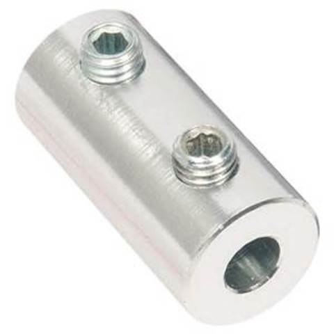

squonk 48,229 #4 Posted October 25, 2015 I solved this by buying a chunk of 3/8 round stock from TSC and got a 3/8" shaft coupler from a hardware store. Cut the length needed and drilled a hole for the snap pin. added the coupler and put the existing rod in and done! Share this post Link to post Share on other sites

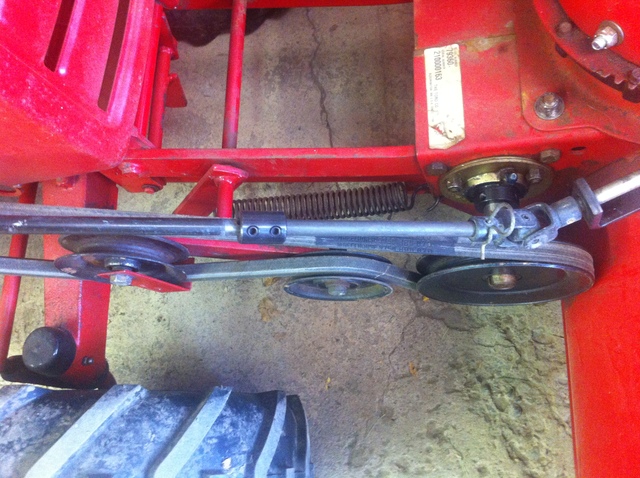

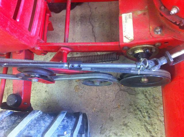

squonk 48,229 #7 Posted October 26, 2015 Here's my extension. 2 Share this post Link to post Share on other sites
boovuc 1,090 #8 Posted October 27, 2015 Looks better than the cotter pins sticking out of the supplied extension! Share this post Link to post Share on other sites
