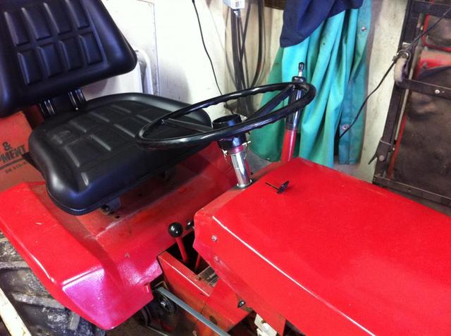

squonk 48,326 #2 Posted October 24, 2015 I used a bearing separator to grip the steering wheel metal hub and a big honkin gear puller to grip the bearing separator to get the wheel off of my 1267. The roll pin was seized in the shaft so I had to shear that as well. Should have took pics. I had to raise the wheel and extend the steering shaft so the wheel would clear the hood. 2 Share this post Link to post Share on other sites

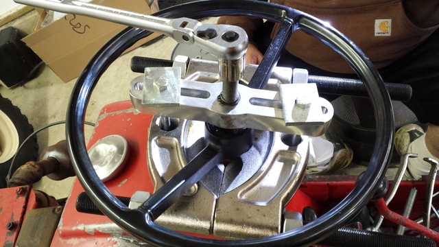

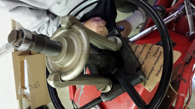

JERSEYHAWG / Glenn 4,590 #4 Posted October 24, 2015 I did the same ad Mike. Pictures below. youll get the idea. What a fight.Glenn 3 Share this post Link to post Share on other sites
