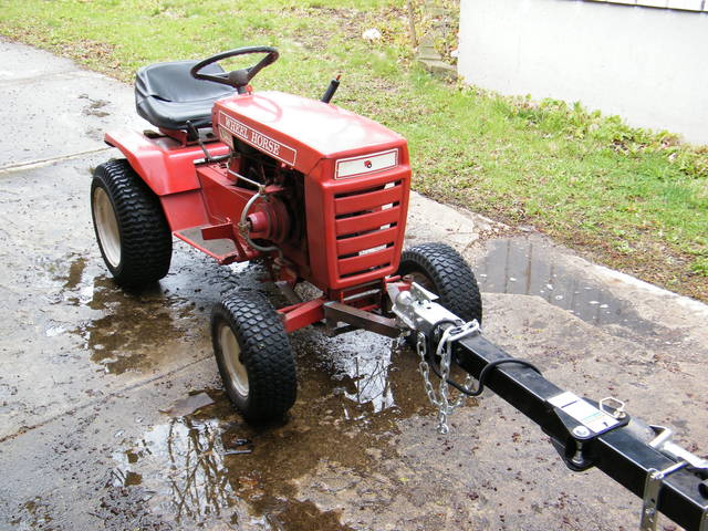

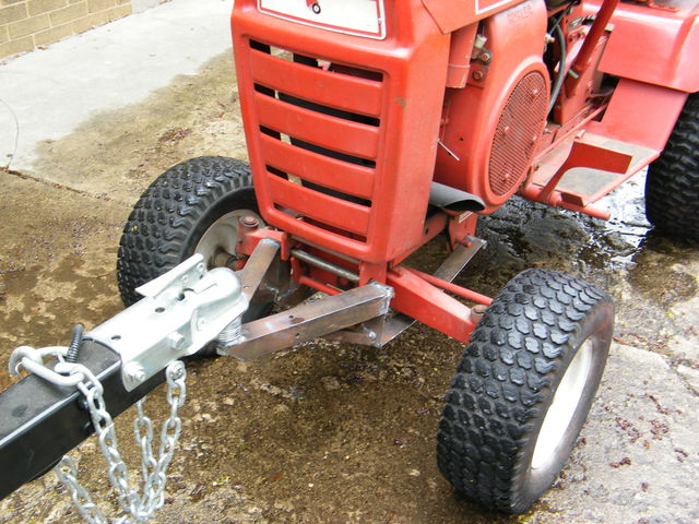

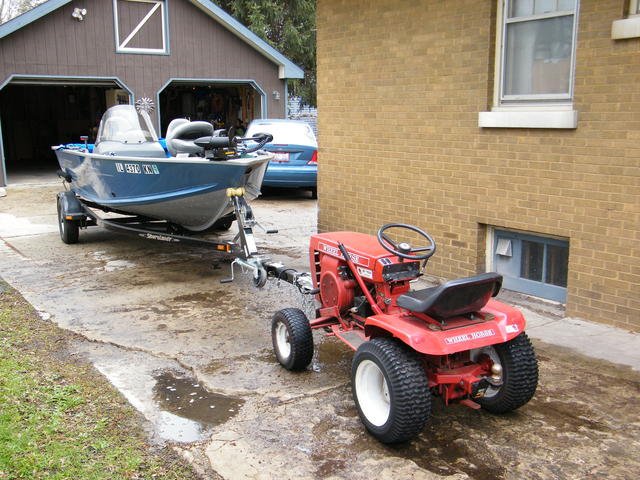

stevasaurus 23,873 #3 Posted October 23, 2015 Of course it is possible to put a 10 pinion, limited slip differential/ trany in that horse. The #5073 would be the best choice because the brake linkage would fit with no modifications...and it may not be hard to find. I don't know if you would solve your problem with one though. It is not really a posi-traction, like a Pontiac, but it will help with what you are trying to do. What may be better...put a good hitch on the front of that horse. It is easier to push and pull something like a vehicle around. Maybe the hitch and the #5073 is where you will end up. 4 Share this post Link to post Share on other sites

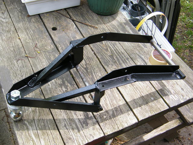

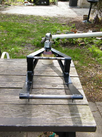

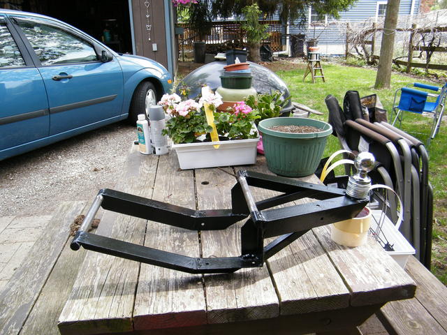

stevasaurus 23,873 #8 Posted October 24, 2015 A good friend of mine, Shorts, made that hitch for me. It works fantastic can come off the horse in seconds. Looks like I should shoot some pictures on the new drive way. 1 Share this post Link to post Share on other sites
98layinframe 23 #9 Posted October 24, 2015 The 5073 is an entire rear unidrive unit. Hope this helps. aahh ok thanks! Yeah doubt I'll get that far into modifying this thing.... yet anyways. A good friend of mine, Shorts, made that hitch for me. It works fantastic can come off the horse in seconds. Looks like I should shoot some pictures on the new drive way. Good friend! Haha. Is it from scratch or is the angle iron and mounts from.an old snow blade or anything? Share this post Link to post Share on other sites
stevasaurus 23,873 #10 Posted October 24, 2015 He got the steel from an old bed frame...here is the link to the thread. http://www.wheelhorseforum.com/topic/47635-pushpull-b-100/#comment-438983I was going to tell you also. If you are serious about getting the #5073 trans...Mike (racinfool40) just may have one rebuilt and for sale...send him a PM. The #5073 transmissions were used on most models from 1970 to 1973...like Raider 10's and 12's. Share this post Link to post Share on other sites
