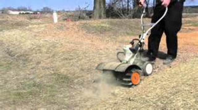

pfrederi 21,225 #10 Posted October 21, 2015 I have done it both ways. I have a gravel drive way and the hyd. lift is nice but very hard to control the plowing height. Half the drive way ends up in the yard. With the dial a height, much better control and less labor in the spring. Thats a great tip squonk. Having pushed snow with my 520H on my long gravel drive and parking areas for the last 18 years any way you can limit the rocks in the yard is well worth the effort. 2 weeks in the spring raking rocks back into the drive way is....... Great excuse to get one of these 1 Share this post Link to post Share on other sites
squonk 48,230 #11 Posted October 21, 2015 I got a power broom for my Sthil Yard Boss. A little easier to store! Share this post Link to post Share on other sites
