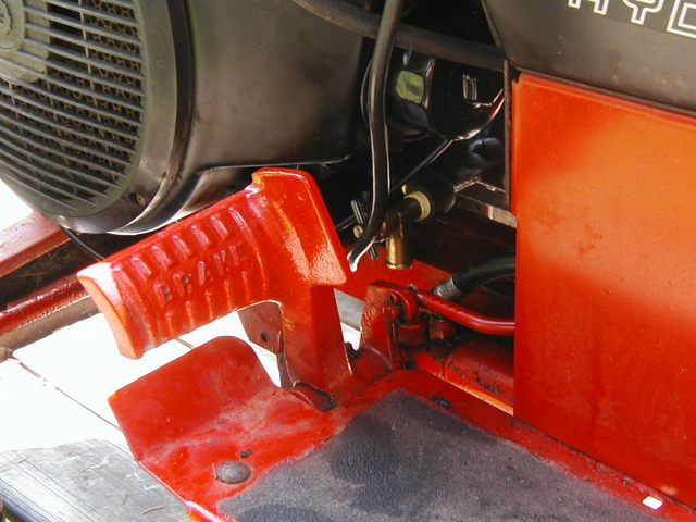

DougC 2,644 #1 Posted October 18, 2015 Getting ready to do an oil and filter change and thought I would see about either fixing loose drain pipe that flopps around or eliminating it alltogather and putting in simple crankcase drain plug. Any advice, suggestions and or experience with would be much appreciated.Been loose for years and been ignoring it... Share this post Link to post Share on other sites

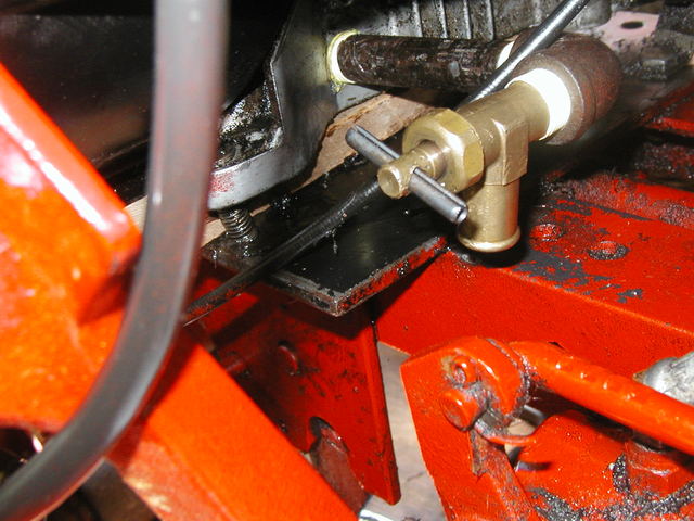

JackC 619 #3 Posted October 19, 2015 (edited) On my 1989 520H, I removed the engine mounting bolts so I could lift the engine to re plumb the drain pipe.I used the high temp, oil resistant yellow Teflon tape and a drain valve from another brand tractor.A John somebody?I attach a plastic tube from the drain outlet down to the container when I do an oil change. Edited October 19, 2015 by JackC Delete extra pics 4 Share this post Link to post Share on other sites

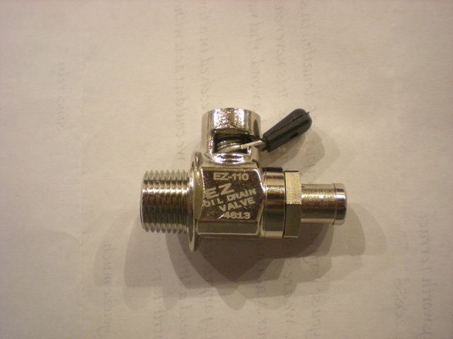

shallowwatersailor 3,221 #5 Posted October 19, 2015 (edited) I have one of these to go on my C-145 the next time I change oil. It originally had a 4 inch nipple and hex cap. The nipple turned out of the oil pan the first time I changed oil! With this I can mount it underneath and use a hose if need be on the optional hose end if the deck is on. I can also tell the position without looking at it.http://www.ezoildrainvalve.com/ Edited October 19, 2015 by shallowwatersailor 3 Share this post Link to post Share on other sites
WNYPCRepair 1,924 #6 Posted October 19, 2015 I have one of these to go on my C-145 the next time I change oil. It originally had a 4 inch nipple and hex cap. The nipple turned out of the oil pan the first time I changed oil! With this I can mount it underneath and use a hose if need be on the optional hose end if the deck is on. I can also tell the position without looking at it.http://www.ezoildrainvalve.com/ Ordered, thanks. Share this post Link to post Share on other sites
