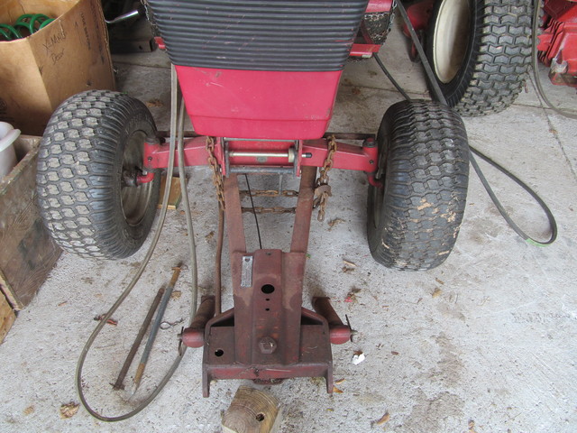

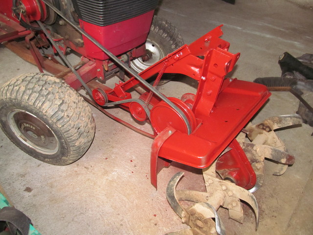

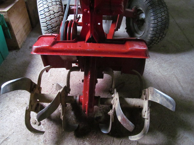

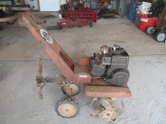

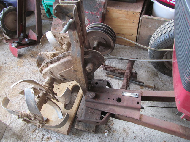

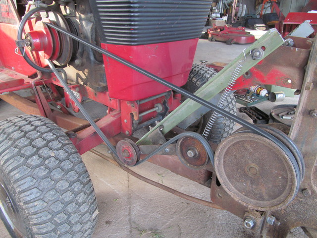

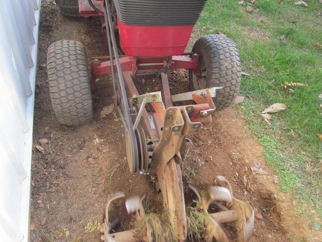

Ed Kennell 47,386 #1 Posted October 17, 2015 A few days ago while I was complaining about my sore shoulders from wrestling this "killer tiller" through my strawberry beds along side my pole barn, Mrs. K made the comment" all those little tractors...can't they help you".Sure enough, the next day when I went to the barn, there sat the 314 Hydro with the blade off for a new scraper bar that a member made for me.........It looked like a mount for a TILLER.A little cutting with the radiac and its ready to mount up.Drill a few holes, add two braces, and make a belt tensioner.More seat time...less sore shoulders. 25 4 Share this post Link to post Share on other sites

WNYPCRepair 1,924 #7 Posted October 17, 2015 Is it spinning in the right direction? I've thought about doing that with my tiller and snowblower, just haven't gotten up the courage to try it. 1 Share this post Link to post Share on other sites
Ed Kennell 47,386 #8 Posted October 17, 2015 As you are viewing the picture, the tiller is turning CW. This is the correct direction for the sharpened edges of the tines.For safety reasons, this requires the tilling to be done in reverse. You always want the tines to enter new ground on the down stroke side so if you hit a rock or root, the tiller lifts up over the obstruction as opposed to hooking it underneath and probably breaking the drive train. This is the opposite direction from the original walk behind where the downstroke was in front and it was operated in a forward direction. I had to turn the tiller around 180 deg. to get the drive pulley in line with the PTO, therefore the change in direction.Actually it works very well in reverse. I have found I can pull in to where I want to start tilling, put the hydro in neutral, and hold the brake, Then, using the hyd lift, slowly lower the tiller head to the depth I want. Then just using the brake to control speed, let the tiller push the tractor in reverse. 7 Share this post Link to post Share on other sites

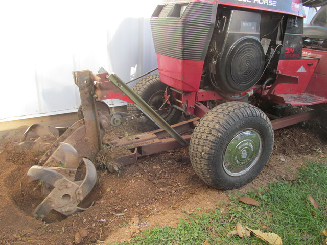

Ed Kennell 47,386 #21 Posted October 25, 2015 I`m impressed Ed, nice job. I guess being hooked up to that plow frame you can angle it right and left for going around corners. LOL. Thanks J, I was actually surprised at how well It works. I thought I may have to add weight to keep it in the ground, but it works fine as is to till my garden.If I were tilling sod or unplowed , I would probably need to add weight. For safety reasons, I do not want to add a solid link on the lift because I know if I hit a big rock or root, the tiller is going to come up and I don't want it trying to lift a 500 lb tractor with me on it.As far as angling to till around corners, I'll have to redesign the belt tensioning system and add about 6 more idler pulleys. I'll work on that for you.I am adding some guards and red paint to make it to make it look a little less scary. Still don't think OSHA will put a blessing on it though.I'll post a pic before I take it off to put the blade back on. 1 Share this post Link to post Share on other sites

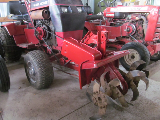

Ed Kennell 47,386 #22 Posted October 25, 2015 Got rid of the MAD MAX look. 8 2 Share this post Link to post Share on other sites

Ed Kennell 47,386 #25 Posted December 3, 2015 OK, I added the belt guard. Ready for the OSHA inspection and the patent application. 9 1 Share this post Link to post Share on other sites
