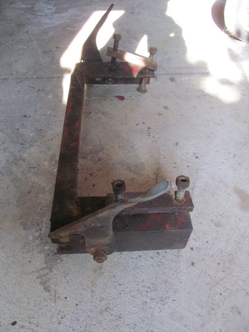

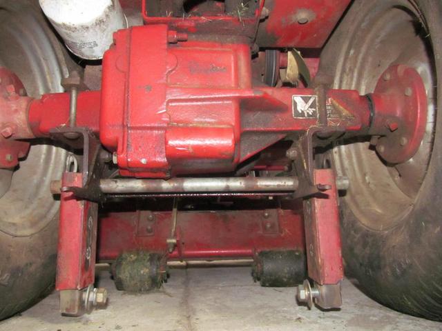

Ed Kennell 46,557 #16 Posted October 17, 2015 Does this help? These are the two types of axle brackets. You need the one in the lower pic where the dozer frame pin enters the notch from the bottom. Ignore the piece of frame in the pic. I altered a frame to work on any tractor....short frame or long frame, and either type of axle bracket. Share this post Link to post Share on other sites

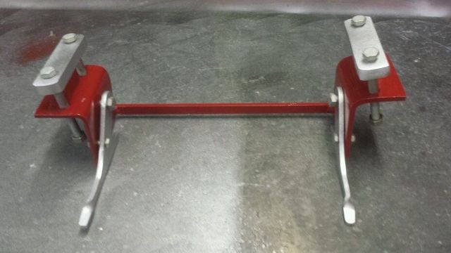

rmaynard 17,422 #17 Posted October 17, 2015 (edited) Just to add my 2-cents worth, here is a picture of a hitch recently offered on eBay. Depending on what tractor you are planning to install it on will determine the actual configuration of the hitch. This is identical to the one on my 416-H with 48" plow, and my B-100 8-speed with 48" plow. Edited October 17, 2015 by rmaynard Share this post Link to post Share on other sites

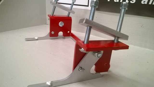

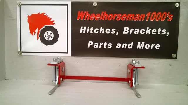

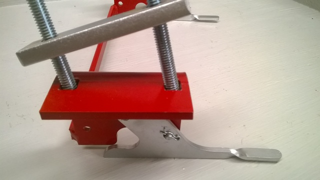

wheelhorseman 3,256 #19 Posted October 18, 2015 I have some PM me if your interested 5 Share this post Link to post Share on other sites
