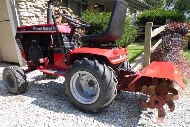

Molon_Labe 731 #8 Posted October 15, 2015 (edited) My 416-8 is the go to tractor around my place for all of the "heavy lifting" and it's never let me down. The old Kohler Magnum 16 just keeps rocking along. Tough as nails and asks little more of me than some tlc in the form of routine maintenance. Edited October 16, 2015 by M_Bailey 1 Share this post Link to post Share on other sites
