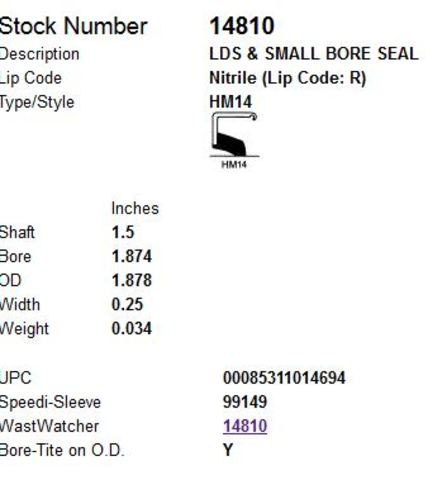

pfrederi 19,924 #1 Posted October 14, 2015 Not sure the best place to post this but...If you have to replace the needle bearing in your PTO bell and its seal here are some numbers.The Bearing is WH #106769 (formerly 6662) about $20. It is a Koyo J-2420 about $10.1.1/2" ID 1-7/8" OD 1-1/4" widthThe sealWH #6663 SKF # 14810 4 Share this post Link to post Share on other sites

doc724 925 #3 Posted October 17, 2015 Here is a question for Cleat and Paul: Have you ever had to replace these bearings and seal and what tipped you off that it was needed? I personally have pulled the PTO bells and regreased the needle bearing with high temp grease (forced it in between the needles). For the thrust bearing, I pushed out the bearing, popped the inner grease seal on the bearing and then forced high temp grease in and reinstalled the seal. All of these were done as a PM. I cannot tell if it made any difference except on the really old machines (late 70's)-they seem to be a little quieter.BTW, all those numbers you a cited are SKF and can be purchased at NAPA Share this post Link to post Share on other sites
