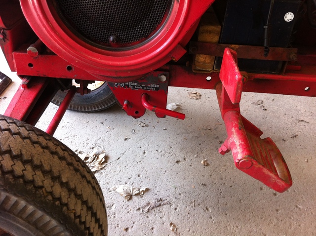

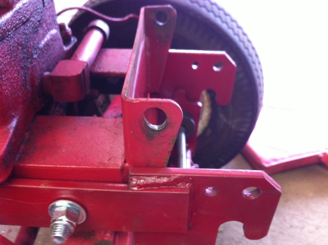

squonk 45,346 #8 Posted October 13, 2015 Rig up a front and mid Tach o Matic like I did to my 1267 and you should be able to run a modern deck and mule drive 1 Share this post Link to post Share on other sites

sdhdcouple 133 #10 Posted October 15, 2015 oh boy thanks a lot. I have acquired over the summer the correct tach-o-matic front hitch. LOL I hope it is all there I bought it back in July and never opened it. will find out this weekend. I think I post my deck question over in the correct area. Share this post Link to post Share on other sites
