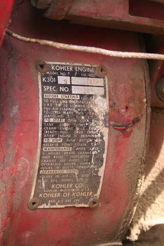

sdhdcouple 133 #1 Posted September 24, 2015 well been busy this summer, no time to be around the computer much. sorry I have been gone.I am having trouble with my tractor, starts runs great. will be going along and it just stops dead, then will not restart. I tow it (LOL push) back to the garage get angry at it go inside and it starts the next day.any ideas?below is the spec plate from the motor. Share this post Link to post Share on other sites
gwest_ca-(File Mod) 12,132 #2 Posted September 24, 2015 1966 - early 1968 12hp with starter/generator and battery ignition.Have you lost spark when it quits?Garry Share this post Link to post Share on other sites
