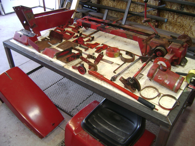

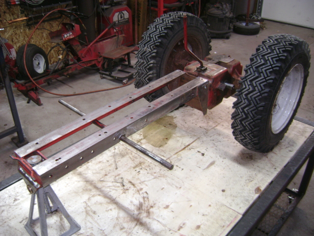

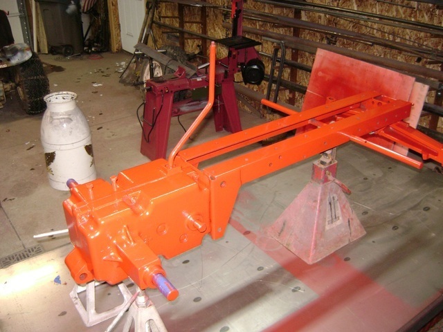

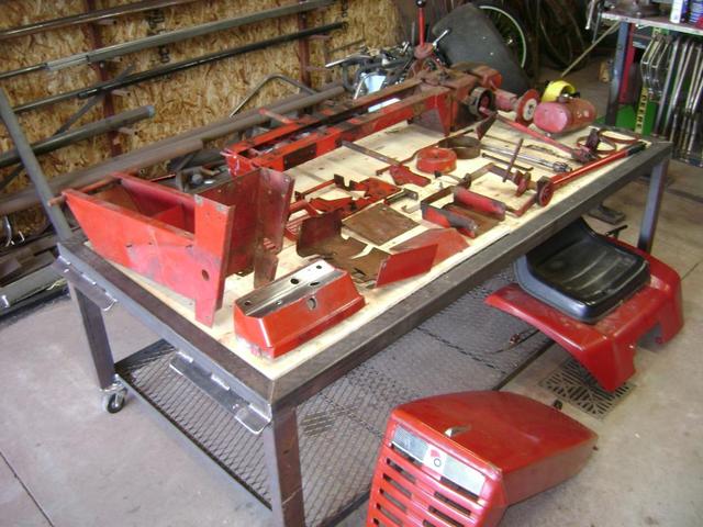

jimkemp 528 #1 Posted October 11, 2015 Well here it is all in pieces now , I learned a long time ago with a restoration that if you take it one piece at a time and make that piece as nice as possible when you start putting all the pieces together you end up with a very nice ending , this wont be a true restoration but more like a resto mod tractor , true color with the right decals but just not every part that it should have , as I took it apart I found that most all bushing are shot and some spots didn't have bushing like the clutch shaft and things like that I am going to put bearings in place of just a hole through the frame rail , going to weld up all holes that aren't going to get used to make the frame look cleaner , 10 Share this post Link to post Share on other sites
AMC RULES 37,259 #2 Posted October 11, 2015 Looks like you've got a good handle on the process...and, you're already well on your way. 2 Share this post Link to post Share on other sites
Wishin4a416 2,604 #3 Posted October 11, 2015 A very nice style tractor to redo. I'm sure it will look great. Will be watching. 3 Share this post Link to post Share on other sites

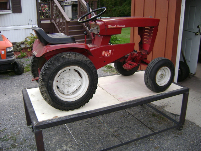

squonk 47,446 #4 Posted October 11, 2015 Very nice work table too Jim! 1 Share this post Link to post Share on other sites
jimkemp 528 #5 Posted October 11, 2015 I had to do the table before I started the tractor , I don't like bending over to work on stuff 1 Share this post Link to post Share on other sites
953 nut 67,524 #6 Posted October 12, 2015 I like your attitude, you can't expect quality results if you take shortcuts. Thanks for sharing. 3 Share this post Link to post Share on other sites
KC9KAS 4,746 #7 Posted October 12, 2015 Looks like you have everything under control for the WH make-over.Thanks for the photos and keep us updated on your progress! 2 Share this post Link to post Share on other sites

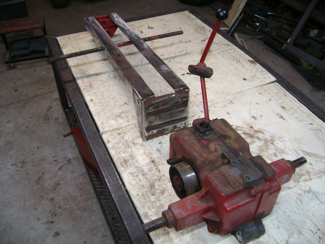

jimkemp 528 #9 Posted October 13, 2015 I got started tonight on getting the frame cleaned up and worked on getting the rear hubs off the axle , WOW did those hubs fight me coming off , but I won , the hard part of cleaning the frame now starts with a good power wash and then sand blast the inside of the frame and weld up all the holes that I wont be using when I start putting it back together , looked at the front axle mounting pin and its about all worn out , not sure what I am going to do there yet but I know I need to do something with it as it is pretty loose , thinking machine out the holes and install bearing but that will come later 2 Share this post Link to post Share on other sites
953 nut 67,524 #10 Posted October 13, 2015 I bet you are loving that work table! If you can find a piece of brass round stock the size of the pivot pin and insert it in the hole it can be welded up and the weld won't adhere to the brass. 1 Share this post Link to post Share on other sites
jimkemp 528 #11 Posted October 14, 2015 I bet you are loving that work table! If you can find a piece of brass round stock the size of the pivot pin and insert it in the hole it can be welded up and the weld won't adhere to the brass. That table is the best thing I have built in a while , just need to find the time to go get a sheet of 1/2" plywood so the top is one piece , all I had at the time was the two pieces so I used them , as far as the holes I really like bushing or bearing , if I weld it up I will still have medal to medal that's just going to wear out again , I think I can do it so you wont see that there is a bushing in there to keep it looking stock 1 Share this post Link to post Share on other sites

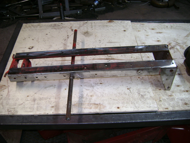

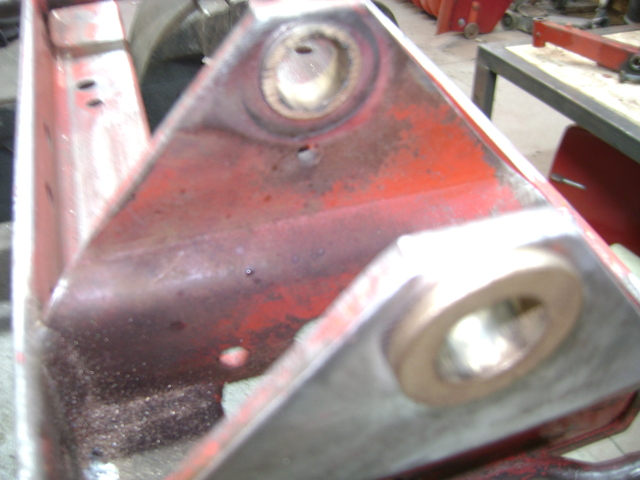

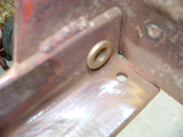

jimkemp 528 #12 Posted November 11, 2015 got a little more done on the 656 , I put bronze bushing for the front axle pin and for the clutch rod that goes through the frame , sorry for the crappy pictures 6 Share this post Link to post Share on other sites

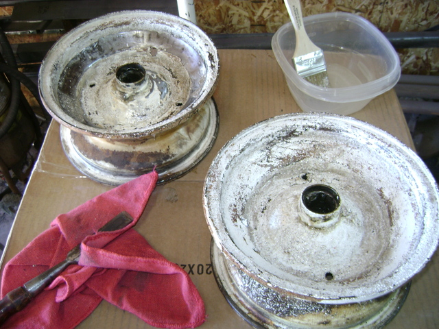

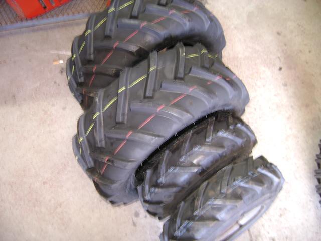

jimkemp 528 #13 Posted November 15, 2015 Well my new tires got here so its time to get the wheels cleaned up and painted , found this paint stripper at Lowes and this stuff works great , its Jasco premium paint and epoxy remover and takes the paint right off , if you try this make sure you wear heavy rubber gloves as this stuff if very strong , hopefully be painting the wheels tonight and getting the new shoes ready for my resto horse 4 Share this post Link to post Share on other sites
Terry M-(Moderator) 2,304 #14 Posted November 15, 2015 Have you thought about splitting the transmission and checking it out? Easy to take apart and fix the 656's 5053 unidrive if anything is wrong.And If all the bearings are good, then at the very least, clean everything up replace the seals , maybe a new shifter boot and it'll be just like new. Will give you a piece of mind that your trans is in good shape.Just a suggestion... 1 Share this post Link to post Share on other sites
jimkemp 528 #15 Posted November 15, 2015 Have you thought about splitting the transmission and checking it out? Easy to take apart and fix the 656's 5053 unidrive if anything is wrong.And If all the bearings are good, then at the very least, clean everything up replace the seals , maybe a new shifter boot and it'll be just like new. Will give you a piece of mind that your trans is in good shape.Just a suggestion... I ran this tractor around before it was taken apart and the trans worked just fine , I did put all new seals on all shafts and drained the oil out of the trans and it came out pretty clean with no signs of metal so I am pretty sure the trans is ready to go 3 Share this post Link to post Share on other sites

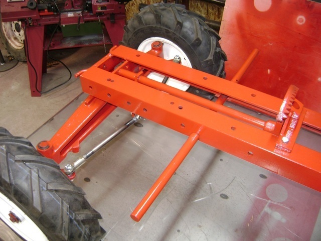

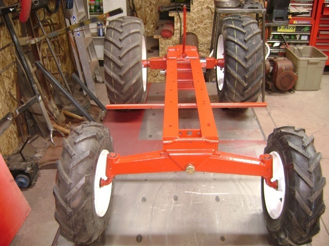

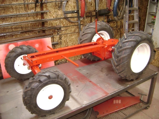

jimkemp 528 #16 Posted January 15, 2016 Well I got my 656 frame paint and ready to start bolting on parts , need to get going on this project as I want to put a snow blade on it to go along with my c120 with the blower , the blower is nice but I miss being able to plow snow to , and yes I need a new camera , the color is IH red from tractor supply , more to come later 4 Share this post Link to post Share on other sites

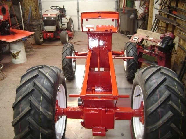

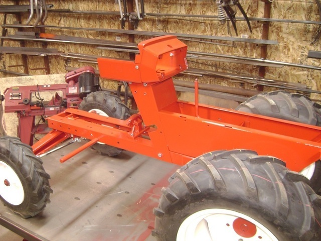

jimkemp 528 #17 Posted January 17, 2016 Well my horse is back on her feet , some more paint work and I can start putting the body on 8 Share this post Link to post Share on other sites
Terry M-(Moderator) 2,304 #18 Posted January 17, 2016 Looking Good...I like the front tires. 1 Share this post Link to post Share on other sites

jimkemp 528 #20 Posted January 23, 2016 Some more pictures of my project , body is coming together , and yes I put the tie rods on the wrong side of the steering arm , just got in a hurry but they have to come off to be painted later anyway 7 Share this post Link to post Share on other sites

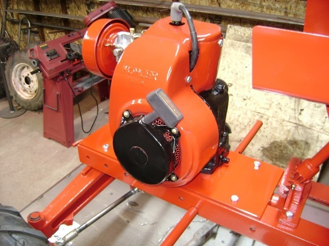

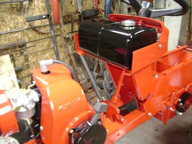

jimkemp 528 #21 Posted January 29, 2016 I got the frame plate mounted tonight and the motor set on , progress is slow but still moving forward 9 Share this post Link to post Share on other sites
Terry M-(Moderator) 2,304 #22 Posted January 29, 2016 Looking Good!!.......The Engine..K-91? Share this post Link to post Share on other sites
jimkemp 528 #23 Posted January 29, 2016 Yup , K91 and I am going to change the pulley size on the trans to give the little girl some help in the power dept Share this post Link to post Share on other sites
Pullstart 70,795 #24 Posted January 29, 2016 The story... a never ending mix of options and points of view! Great work, whoda thunk to use a mini mill for power I bet that will be a blast to put around on! 1 Share this post Link to post Share on other sites
jimkemp 528 #25 Posted January 30, 2016 11 hours ago, pullstart said: The story... a never ending mix of options and points of view! Great work, whoda thunk to use a mini mill for power I bet that will be a blast to put around on! Well this tractor came with a 6hp , so going to a 4hp that is bored .020 over and a reground cam to help with the HP should work ok I think , if I find later that its not enough power I will then change out the stock carb to a racing go kart carb and then would be well above the 6hp mark , its only going to be pushing a small snow plow that I am going to fab up once the tractor is done that will be about half the weight for a stock wheel horse plow , My C120 will do all the hard work with the snow blower and this one will do the clean up work 3 Share this post Link to post Share on other sites
