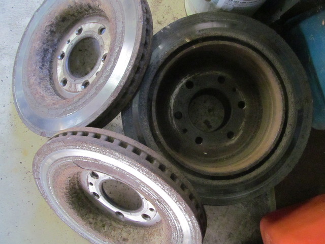

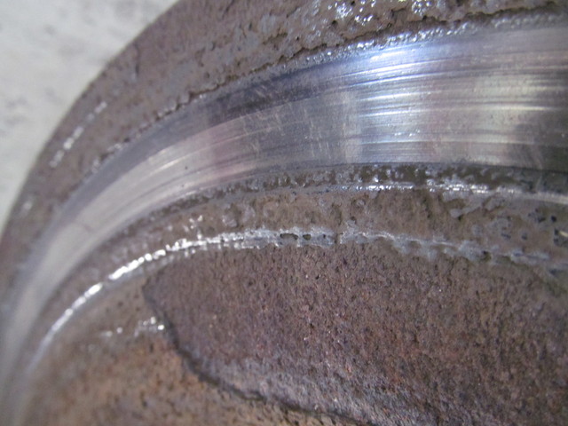

Ed Kennell 44,401 #1 Posted October 10, 2015 Just had the required annual state inspection done on my F-150 4X4 . This is what was found on the inside surfaces of all 4 rotors. The outsides , that we all can see were all OK. The inside surfaces were pitted too deep to resurface.I bought the truck new and it has 29,500 miles on it. 4 new rotors and pads = $800. Share this post Link to post Share on other sites

squonk 45,199 #10 Posted October 11, 2015 Exactly. The pads clean all the gunk water ect from the rotor surface. When a car sits a long time, or a caliper slider hangs up you get this. One side usually the inside will get rusted out because the caliper isn't freely sliding and the inboard pad isn't touching the rotor surface all the time. It will move under brake pressure but will move too far away from the rotor surface and won't properly clean of the rotor. You will also notice one pad wearing more than the other. And yes, Cheap off shore metal will rot out faster. 1 Share this post Link to post Share on other sites

mikekot3 93 #15 Posted October 11, 2015 I would take the calipers off once a year and apply sil-glide to the caliper slides otherwise my dad's brake calipers get sticky and the right rear inner rotor surface does not get cleaned from the pads when the brakes are applied. The whole vehicle slide lubrication takes about an hour. Much cheaper than new pads and brake rotors. Share this post Link to post Share on other sites

305 380 #22 Posted October 12, 2015 (edited) working part time at an auto parts store i see that all the time , usually caused by the caliper hanging up as already stated. those MAY have been able to turn , don't know for sure until you measure them. some rotors don't have much to work with even when they are new , some have enough to turn a couple times. we charge $12 each to turn a rotor or drum.if you had the work done at a repair shop , i have found that most will not have a rotor turned and insist on new onesmy 1995 Chevy S-10 went almost 300,000 miles with the original rotors , my 2003 Chevy 1500 has 156,000 miles with the original rotors still serviceablecheap Chinese parts has also been mentioned ...we have two levels of brake rotors , most people go for the cheapest ones$800 for rotors and pads seams very high Edited October 12, 2015 by 305 2 Share this post Link to post Share on other sites
