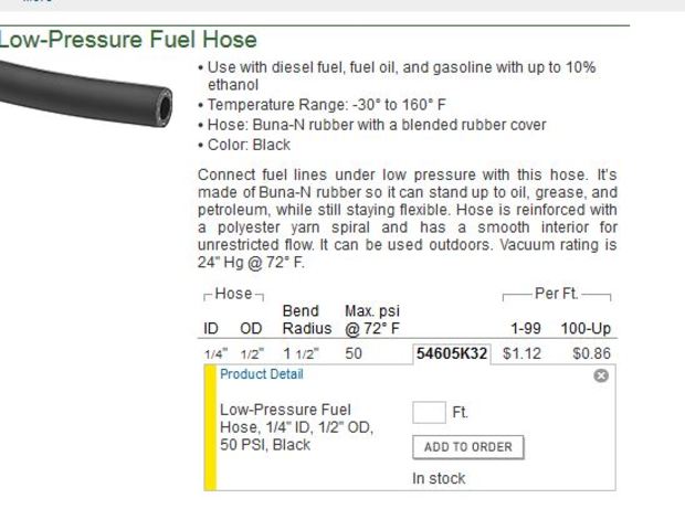

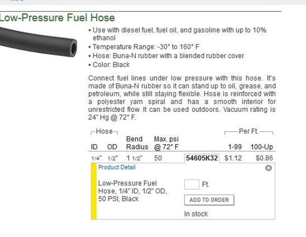

pfrederi 20,905 #2 Posted October 8, 2015 I buy my hose (1/4") from McMaster they have been sending Gates Brand made in USA. Should las as long as anything can. I buy a box of hose clamps (worm style) Size 04 (7/32-5/8") stainless steel. Also put in fuel filters and shut off valves near the filters. 2 Share this post Link to post Share on other sites

WHnoob 21 #5 Posted October 8, 2015 Thanks for the responses so far! Paul - I'll have to order some of that tubing from McMaster - it looks like it might be more flexible than the Ace stuff. What is the purpose of additional shutoff(s) near the filter if there is already one on the tank?Richard - My small engines have been ethanol-free 91 octane for a couple years now. Too expensive for cars, but totally worth the extra $$$ for the few gallons per year the small engines use. Plus it happens to be my nearest gas station and they make some tasty apple sausage and smoked salmon Jack - Do you mean the short length between the fuel pump and the carb? Where do you get the clear tubing and how often do you have to replace it?Any particular recommendations on the filter model/type?Thanks!-Peter Share this post Link to post Share on other sites
squonk 47,447 #6 Posted October 8, 2015 You can get that same hose that Mc Master sells at Napa. Or you can spend a tad more and get fuel injection hose which has stronger walls. Carful with the filter. Some of those paper ones can get air locked Share this post Link to post Share on other sites
