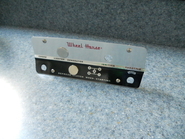

Racinbob 12,996 #9 Posted October 13, 2015 Here ya go. This is the first one of this style I've done. I may order another decal and do it again but I know you wanted to see it. The bottom of the dash is straight. I butted it up against a straight edge so I could do the same with the decal which would help getting it on square. Working from the bottom up with a plastic card I made sure it was tucked in to the horizontal center area. Once it was on I saw that it was a bit oversize and trimming was required on the top and sides. Doing it again I would overlap the bottom just a little and trim all the way around. That would drop the 'Depress clutch when starting' down and get it away from the generator light plug as well as lowering the wording so it would center on the ridge better. I'm thinking it may have been made a bit large and intended to be trimmed. Maybe Terry will chime in here. 7 Share this post Link to post Share on other sites
elcamino/wheelhorse 9,363 #10 Posted October 13, 2015 That looks great. Share this post Link to post Share on other sites
Racinbob 12,996 #11 Posted October 13, 2015 Thanks. Terrys decals are outstanding. Share this post Link to post Share on other sites
Aldon 4,832 #12 Posted October 13, 2015 Looks like new ! Share this post Link to post Share on other sites
