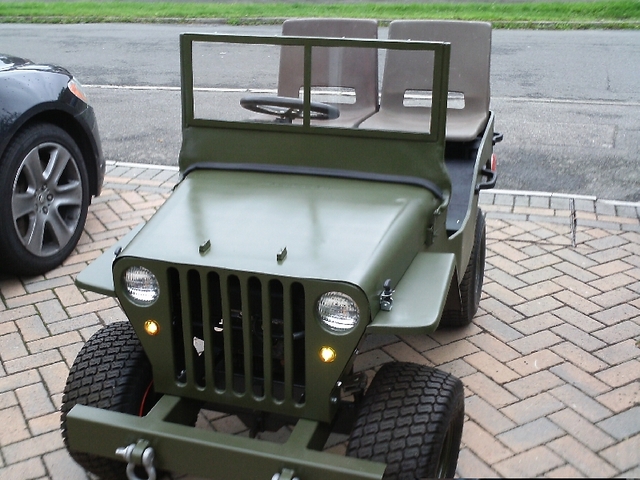

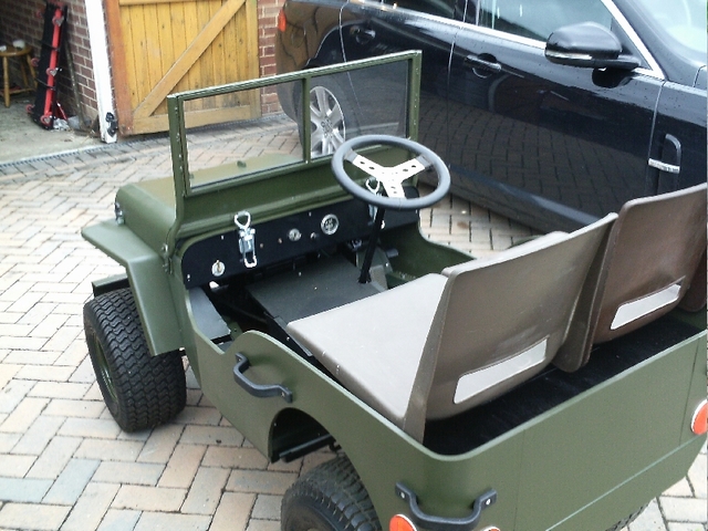

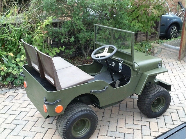

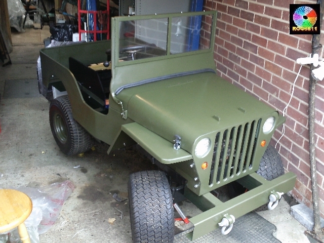

rog 8811 33 #5 Posted October 16, 2015 I built this one on a Westwood tractor chassis. 8 Share this post Link to post Share on other sites

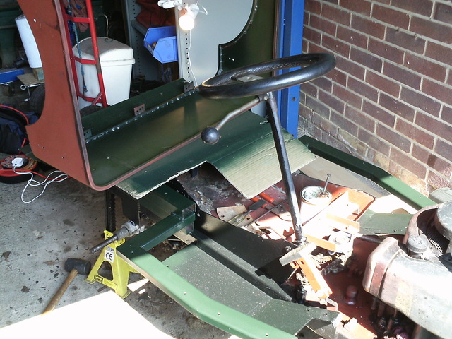

AMC RULES 37,260 #6 Posted October 16, 2015 Looks really nice... any picts available of the build in progress? Share this post Link to post Share on other sites
C-101plowerpower 1,606 #7 Posted October 17, 2015 (edited) I think there was a build thread on my old machine onder the homebuild tabhttp://myoldmachine.com/topic/2095-my-westwood-mini-jeep/ Edited October 17, 2015 by C-101plowerpower Share this post Link to post Share on other sites
DennisThornton 4,773 #8 Posted October 17, 2015 I think there was a build thread on my old machine onder the homebuild tabhttp://myoldmachine.com/topic/2095-my-westwood-mini-jeep/ Before, after pictures and no middle! Dang! OH! Reading instead of just looking revealed:http://www.instructa...-ride-on-mower/Yep! Worth a look! http://www.instructables.com/id/Gas-petrol-powered-jeep-from-ride-on-mower/Thank you! Share this post Link to post Share on other sites

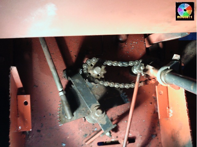

ol550 879 #11 Posted October 18, 2015 Rog, Steering wheel is on the wrong side. 2 Share this post Link to post Share on other sites
DennisThornton 4,773 #12 Posted October 18, 2015 (edited) Rog, Steering wheel is on the wrong side. He mentioned that. What I want to know is how he DID that! Edited October 18, 2015 by DennisThornton "he" Share this post Link to post Share on other sites
rog 8811 33 #13 Posted October 18, 2015 (edited) Rog, Steering wheel is on the wrong side. He mentioned that. What I want to know is how it DID that! Two chain wheels and a short loop of motorbike chain. There is a plumber block, not shown on the second picture, that holds the top end of the old steering column stub. Edited October 18, 2015 by rog 8811 Share this post Link to post Share on other sites
DennisThornton 4,773 #14 Posted October 18, 2015 Rog, Steering wheel is on the wrong side. He mentioned that. What I want to know is how it DID that! Two chain wheels and a short loop of motorbike chain. There is a plumber block, not shown on the second picture, that holds the top end of the old steering column stub. Cool! There's always a way! Very nicely done! Share this post Link to post Share on other sites
