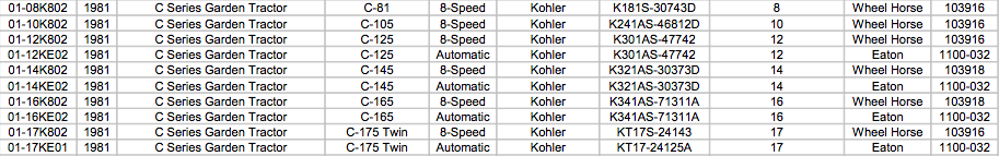

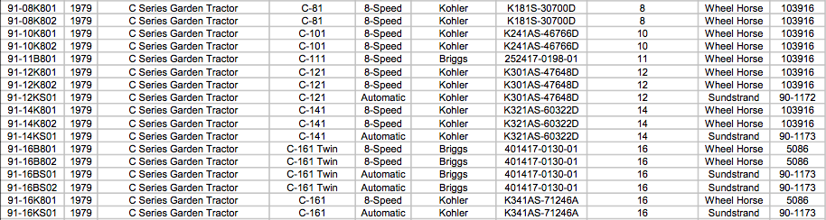

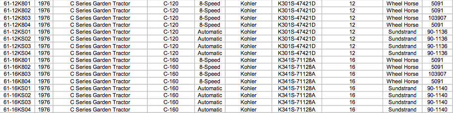

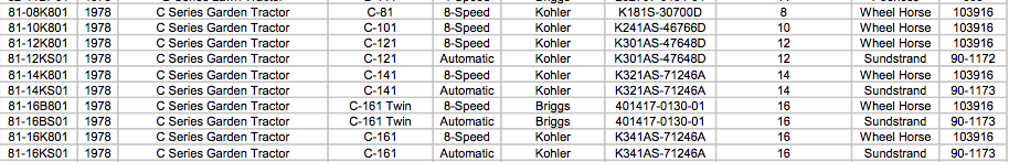

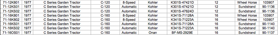

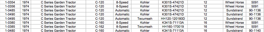

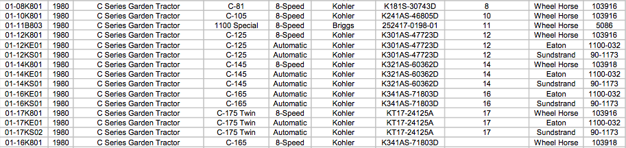

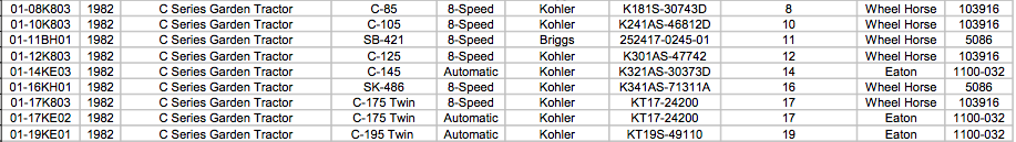

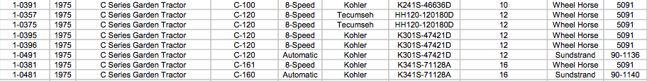

fireman 1,022 #13 Posted October 4, 2015 I forgot about the different hydro transmissions. Here are some screen shots from the master list that lists the model number, year, engine, transmission etc. for all the "C" series 2 Share this post Link to post Share on other sites

elcamino/wheelhorse 9,363 #15 Posted October 4, 2015 I was looking art the screen shots provided by fireman and I wonder if anyone knows the difference between the 1974 1-0485 and 1-0490 C120 tractors. Both have 12 hp Kohler motors and both have Sundstrand 90-1136 transmissions. It seems that this happens in other years , different model numbers but the same Manufacture modle and Hp engine and the same model transmission. Just wondering . Share this post Link to post Share on other sites
Ed Kennell 47,223 #16 Posted October 5, 2015 Could that have been with and without hyd lift cylinder ? Share this post Link to post Share on other sites
