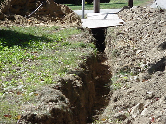

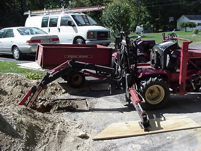

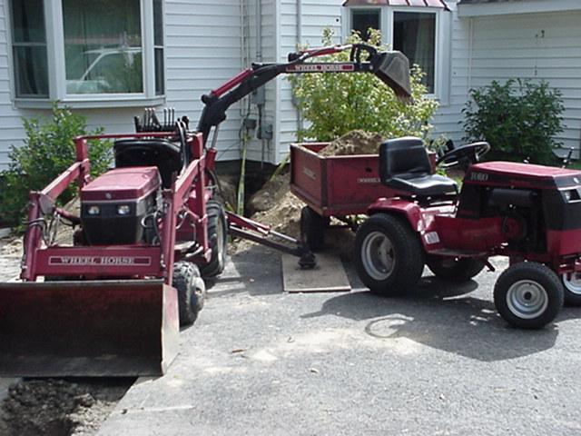

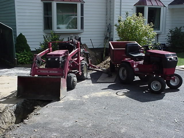

wallfish 20,682 #2 Posted October 2, 2015 (edited) YUP, made this attachment but not for a french drain. Buried my utilities and other things but doubt this will help you at the moment.How deep do you have to go? Maybe you can rig something up with a moldboard plow. Dig as far as it will go hooked up normally and then fabricate something to hold it down deeper in the trench??? Just thinking out loud. Check out this cool attachment.https://www.youtube.com/watch?v=NBAzvl95BGk&feature=youtu.beIf you have quite a bit to do you can rent a real trencher for the day. Edited October 2, 2015 by wallfish 2 Share this post Link to post Share on other sites
