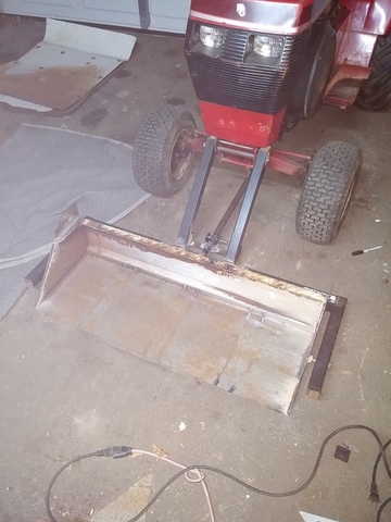

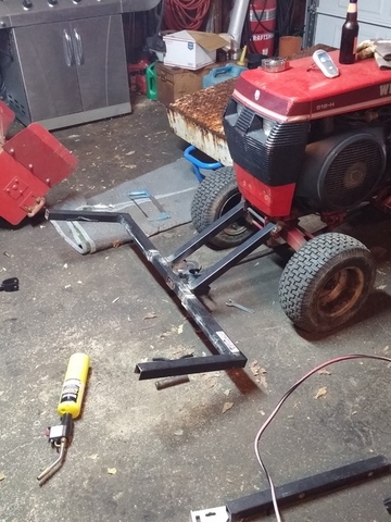

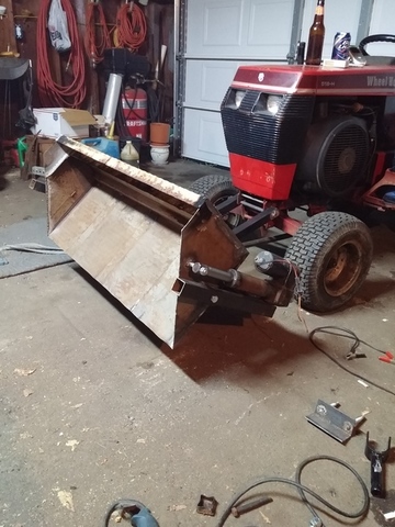

JaysHorse 288 #1 Posted October 2, 2015 So I had some scraps laying around and thought how nice it would be to eliminate the wheelbarrow. So it began. The creation of a Johnny bucket. 16 Share this post Link to post Share on other sites
RedRanger 1,470 #2 Posted October 2, 2015 Very nice job. I see the electric scoop. You lifting it by hand? 1 Share this post Link to post Share on other sites
JaysHorse 288 #3 Posted October 2, 2015 Thank you. No it has the factory electric lift that was added on by original owner. I tested it by lift myself which is 180lbs. 5 Share this post Link to post Share on other sites

Ed Kennell 47,618 #7 Posted October 2, 2015 Nice....does it have down pressure for back dragging. Looks like a good tool for stone road maintenance and mulch or top soil spreading. Does the electric lift have overload protection? 2 Share this post Link to post Share on other sites
elcamino/wheelhorse 9,363 #8 Posted October 2, 2015 Great job , I like it . Do you have electric lift on both sides of the bucket? 2 Share this post Link to post Share on other sites
JaysHorse 288 #9 Posted October 2, 2015 Thanks for all the compliments! No down pressure as I have it on the same mechanism as for the snow blower. Hoping to modify it so there will be. I have actuator on one side but a stop on the other to support. I'm hoping to be able to test it out this weekend. If it doesn't work so well, I'm thinking of welding on 2 hinge pins on the bottom back side and eliminating the side bucket attachments. Then I can mount the actuator in the middle. I have seen some designs of this style and had mixed reviews. If it's a fail this way I'm only out some time. And I will try my second idea which I like better but as they say that idea was a day late and a dollar short. 3 Share this post Link to post Share on other sites

Scrumpy 5 #11 Posted October 2, 2015 Does the electric lift use the bell crank same as the hydros? What are they rated to lift? 180 is a lot more than a blower. Share this post Link to post Share on other sites
bmsgaffer 2,071 #12 Posted October 2, 2015 (edited) Ill bet a snow blower weighs close to 180... a two stage is probably more than 200.the 60" mower deck is 300+lbs but thats a dead lift. I will bet there will be issues lifting a full bucket with the bellcrank. Be careful or you may crack it. Edited October 2, 2015 by bmsgaffer 1 Share this post Link to post Share on other sites
Scrumpy 5 #13 Posted October 2, 2015 (edited) Cool project so don't take any of this wrong please. In fact I am very interested in how this performs.Ok, I'll give you 150 as a can pick mine up but barely. but the bucket and frame are already half the weight of a blower(maybe). Then add the payload. Just wondering what a bell crank can take if that is how it is setup.and I have had to weld up my bell crank after the pivot bar failed from stress Edited October 2, 2015 by Scrumpy 1 Share this post Link to post Share on other sites

JaysHorse 288 #15 Posted October 2, 2015 (edited) So maybe I should have specified my uses. I'm not starting a landscape business is excavating company. My intentions are to move some mulch, leaves, wood chips from splitting, and a little topsoil. If it were anything more I'd be crafting a regular FEL. Don't take any of this the wrong way. I do appreciate the + criticism and things to watch out for. And hey, I'm just playing within my means and enjoy tinkering. They are a warner electric lift so i don't doubt tthe durability for a minute. Not sure on the lift limit but I'm sure I will find out. Hydros would be nice but you hoarders of the 520's and such hate giving things up. Lol j/k Edited October 2, 2015 by JaysHorse 6 Share this post Link to post Share on other sites

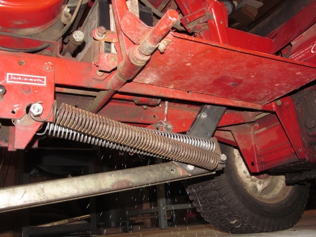

Ed Kennell 47,618 #18 Posted October 3, 2015 Just a thought you may want to consider Jay. I have used multiple lift assist spring on my manual lift blower (before I got the 520H) . I made the springs from old scrap garage door springs, and with a turnbuckle was able to totally tare out the weight of my blower. By tuning the spring tension with the turnbuckle. I was able float the blower several inches above ground level and as it entered the snow, the additional snow weight pulled it down. It took maybe a 10lb pull to raise it to max height and 1-2 lbs push to hold it down in scraper position.The same principle could be used on your bucket where the springs were tensioned to tare out the weight of the bucket + half the max payload. The electric lift would then only need enough force to lift or lower 1/2 the payload weight. This would greatly reduce the stress on the bell crank. As always, with stored potential energy, caution must be exercised. 6 Share this post Link to post Share on other sites
JaysHorse 288 #19 Posted October 3, 2015 (edited) That is a great idea. I was doing something similar. I have one of those springs that is currently used when the blower is attached. I think I'm going to do some changes and utilize the middle tac a matic because there is a little flex in the rod to raise and lower due to the length. I will post pics of the changes when complete. Stay tuned........ Edited October 3, 2015 by JaysHorse 2 Share this post Link to post Share on other sites
