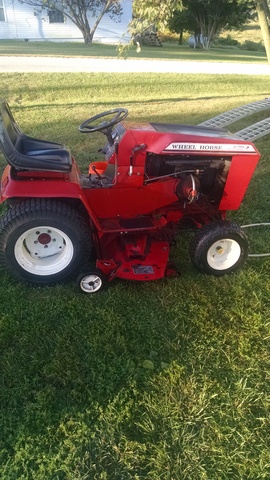

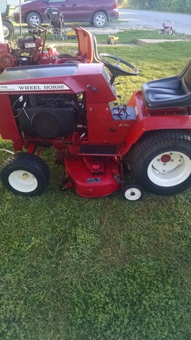

slammer302 2,157 #1 Posted October 1, 2015 I met Bowtieguy/Frank today in Springfield and he brought me this C-175 auto its in pretty good shape no knocks or smoke i know the series 1 kt17 can be a time bomb but this one seems good it ran kinda ruff at first but it ended up being pretty much out of gas after that it ran good the steering is stiff but the trans is very strong and the deck works well and i added a metal seat pan i think i might see if my brother wants it so i can get my 314H back. 15 Share this post Link to post Share on other sites

JackC 619 #3 Posted October 2, 2015 (edited) " i know the series 1 kt17 can be a time bomb". Only if you use it on steep inclines or let it run out of oil. Otherwise they are as rock solid as any of the others.CAUTION: Do not operate enginecontinuously at an angle exceeding20° in any direction, or for more than 5minute intervals at angles up to 30° inany direction-as engine damage mayresult from lack of sufficient lubrication.The C-175 is a beast. That one is a beauty and would get a stall in my barn. Edited October 2, 2015 by JackC 3 Share this post Link to post Share on other sites

Pollack Pete 2,273 #12 Posted October 3, 2015 I really like those Kohler 17 horse twins.Only thing I like a little more are the 19 twins.Smooth and sweet running engines.Have fun with your new toy.it looks great. Share this post Link to post Share on other sites
Wheel-N-It 2,978 #13 Posted October 3, 2015 Yes, thats a very nice 175 Share this post Link to post Share on other sites
