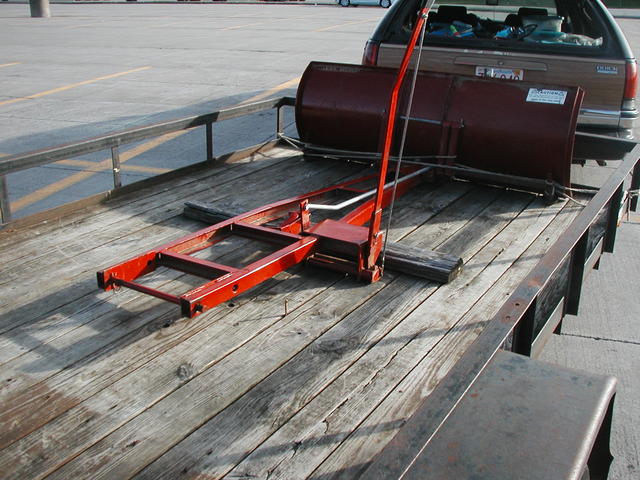

JackC 619 #3 Posted September 30, 2015 Just picked up this bad boy for my Brute D-160. These plows are unique to the D Series with a much larger blade. 1 Share this post Link to post Share on other sites

pacer 3,180 #5 Posted September 30, 2015 Dang Jack, that thing looks like it came off a D-8 cat!!I've got 4 D's and a good hand full of attachments but --- whoa! that is a large blade. 1 Share this post Link to post Share on other sites
