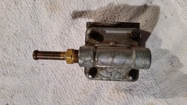

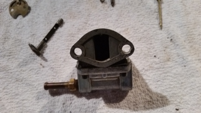

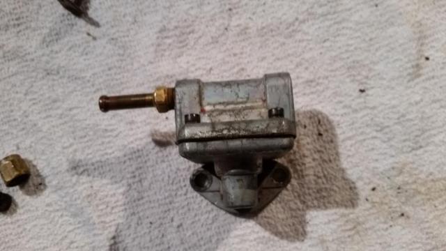

parafrog88 5 #1 Posted September 29, 2015 Working on an 855 with a Kohler K 181 Serial number 928155 Spec 30108A.carb and tank had old gas in them and the float was full of fuel. Got a rebuild kit and took off the fuel pump and no arm for an actuator. Is this vacuum operated? No numbers just Made in the USA on one side and a B on the other. Is it rebuild able ? Should I open it up to see what it looks like inside? where can I get the little rubber plugs that seal the fuel lines to the fittings from the fuel pump to the carb.Thanks for the help. Share this post Link to post Share on other sites
Agage1 83 #2 Posted September 29, 2015 Its a pulse pump Share this post Link to post Share on other sites
Shynon 7,728 #3 Posted September 29, 2015 it is rebuildable, rubber fuel line seals available from Kohler, don't remember the number, I think Buckrancher sells the small gasket between the two halves. Share this post Link to post Share on other sites
rmaynard 17,642 #4 Posted September 29, 2015 (edited) Buckrancher sells the diaphragm, and Kohker sells the rubber gasket (220547-S). You can also get a brand new OEM fitting for the same price as just the rubber piece alone. Comes with all three pieces, male, female, and rubber seal.http://www.wheelhorseforum.com/topic/45214-broken-line/#comment-415701http://www.mrostop.com/68vl-3-2-parker-vibra-lok-adapter.html Edited September 29, 2015 by rmaynard 1 Share this post Link to post Share on other sites
