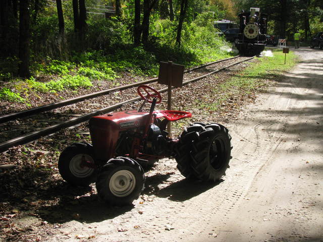

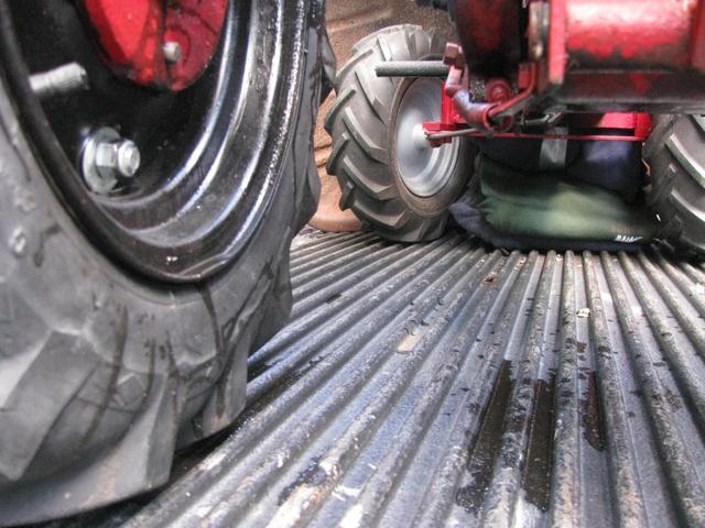

goblbustr 9 #1 Posted September 28, 2015 Alright gents, gonna start my c 120 and c160 refurbs soon and was going over some ideas. The one thing I am just not sure about are duals. I am going to completely tear down and redo both tractors, one at a time of course, and get that new car smell back into them but they will be workers (pulling a plow, tilling, disk, cultivators). With that said, after doing some searching on the site I am finding that there are some concerns about duals. Now I am not sure what I want to do. I sure as heck love the looks of them but I'm not sure about the risk of snapping an axel or cracking a caseing. Have any of you used duallys as workers and if so have you had any issues or have you known of any one that has? What would you do? Share this post Link to post Share on other sites
Ed Kennell 45,719 #2 Posted September 28, 2015 Put the duals on your parade horse and leave the singles on the workers. If you want more traction, load the tires, add wheel weights, ags, and dual link chains. 3 Share this post Link to post Share on other sites
can whlvr 994 #3 Posted September 28, 2015 I agree,duals look great but put a lot of extra stress on the axles Share this post Link to post Share on other sites
AMC RULES 37,256 #4 Posted September 29, 2015 I can honestly say... I've never had an axle issue, running duals. But, if you've got weak axle seals, and don't know it... running a set of duals will definitely help you figure that out. 1 Share this post Link to post Share on other sites
Sparky-(Admin) 24,980 #5 Posted September 29, 2015 I think the only reason anyone needs duals is for stability, there is no gain in traction. So a loader-machine or a tractor used to mow hillsides is about it. I suppose the cool looking factor is another reason.Mike......... 2 Share this post Link to post Share on other sites
alswagg 128 #6 Posted September 29, 2015 I have a set of dual ags which are also filled with antifreeze for my loader back hoe. This gives me 4 26" matching ags filled with liquid an extra 500 lbs if you count the weight of the dual tires and wheels. I add these when I am using the loader a lot very easy to install. I use a dual wheel ring kit designed for a ditch witch trencher. 2 Share this post Link to post Share on other sites
