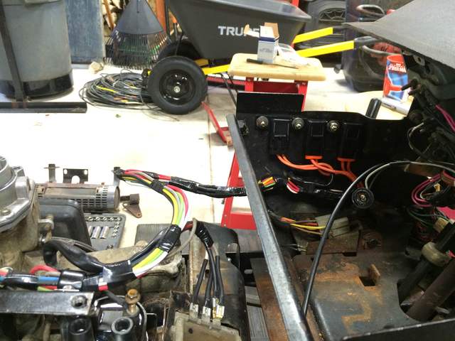

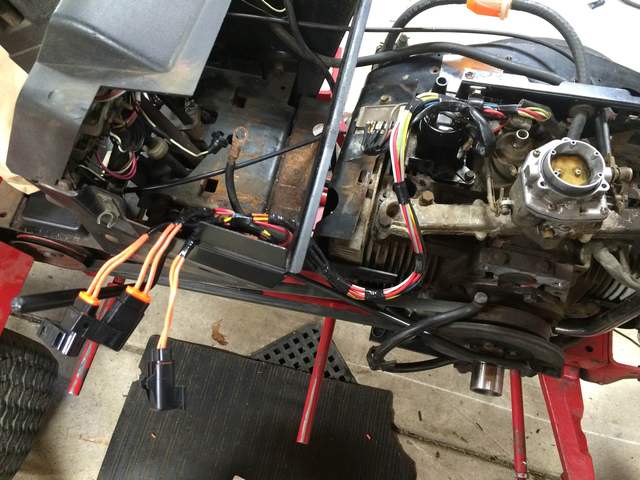

Bow_Extreme 584 #3 Posted September 28, 2015 (edited) If your not planning on taking the engine out anytime soon, remove the old crappy connector and solder and shrink wrap the connections. Also, the fuse block next to the battery is a huge problem area. I recommend removing the fuse block and soldering and shrink wrapping all the connections to inline sealed fuse terminals. I would also check the connections to the regulator, starter, & coil. Most homeowner bypasses are not checking/caring for the condition of the connector or fuse block. Yes, as stated by mikekot3, the connector is readily available. Might not be a bad idea to to buy a couple cans of CRC Electrical cleaner and pull the connectors from every terminal including safety interlocks and clean them. I also pack these connectors full of CRC Di-Electric grease to keep these problems from ever happening. I know, I go over board but I never have issues again.Here is an example of what I just finished on a 520H: Edited September 28, 2015 by Bow_Extreme 5 Share this post Link to post Share on other sites
rokon 64 #4 Posted September 28, 2015 very nicely done, remove any potential causes for high resistance. Share this post Link to post Share on other sites
