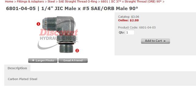

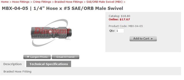

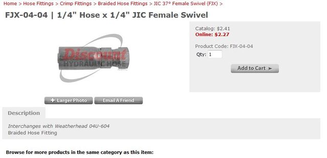

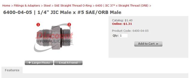

pfrederi 20,675 #6 Posted October 7, 2015 (edited) #5 SAE ORB is the fitting size in that goes in the cylinder. You are not going to find it at TSC.Some ideas Note Price in ORB#5 Hose end...I have not found a source for swivel elbow SAE5 Hose ends at any price Edited October 7, 2015 by pfrederi 2 Share this post Link to post Share on other sites
