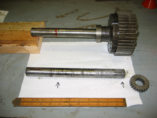

pfrederi 21,274 #9 Posted September 28, 2015 When needle bearings go bad stuff happens like this 2 Share this post Link to post Share on other sites

SPINJIM 1,997 #11 Posted September 29, 2015 OK., you all convinced me. I'm going to split the trans, check the axles, and look for other pieces of the bearing. As you all have said, it's better to make sure now rather than regret it latter. I've always wanted to see the inside of a UniDrive first hand anyway. I just can get to it until I finish three other WH projects, so it may not happen until springtime. After seeing the pictures of the axle from pfrederi, I want to see how chewed up the axle is. Also, if the right bearing was bad, good chance the left bearing is also. Are replacement axles available???Thanks for all of the replies. You may have saved me a lot of headaches. Jim 3 Share this post Link to post Share on other sites
