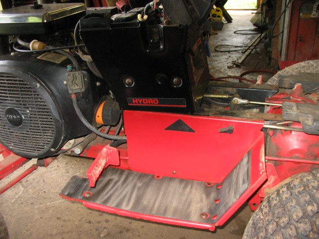

Bow_Extreme 581 #1 Posted September 25, 2015 I have a favor to ask the group. I'm in need of a picture taken from the sides(Both Sides would be great), of the intersection of the Belt Drive Cover(The Hydraulic line cover), the Seat Pan, and the Top Cover between the seat pan and the dash tower. If you have pictures of the top with the seat pan removed and the front cross member still attached that would be great too. My panels do not line up to say the least and something does not look right with the way they are aligned. I've had at least 5 - 520H's and this is the only one that does not line up. Just wondering what it should look like. Here's a picture as an example: Share this post Link to post Share on other sites

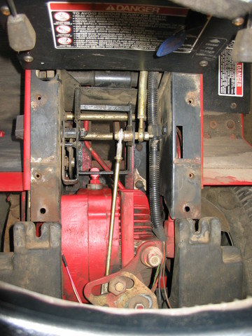

daveoman1966 3,882 #2 Posted September 25, 2015 like thjis : Share this post Link to post Share on other sites
Bow_Extreme 581 #3 Posted September 26, 2015 (edited) Yes, that is what I was looking for. Thank You!! But there is a cross bar that mounts the front of the gas tank as well. I was looking for the stackup of parts. Mine just looks strange. Edited September 26, 2015 by Bow_Extreme Share this post Link to post Share on other sites

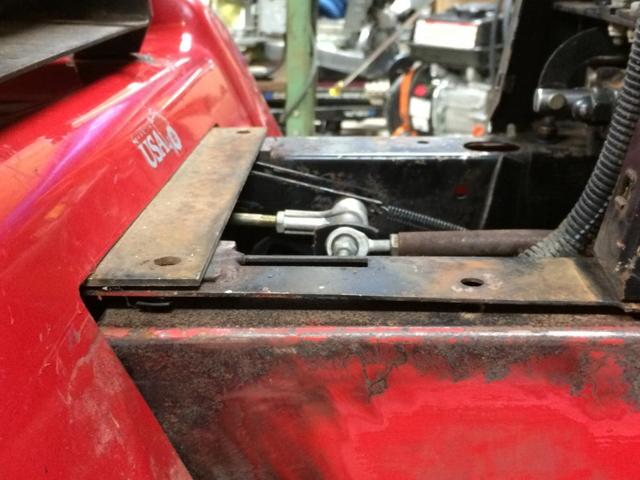

cleat 8,938 #4 Posted September 26, 2015 In the picture in the first post, the rear of the tunnel has been welded up and has some extra thickness added. This could cause some panel alignment issues. Share this post Link to post Share on other sites
Bow_Extreme 581 #5 Posted September 26, 2015 I'm guessing they welded this up due to the common issues with the holes cracking and falling apart in the main frame. When I get some time I'm going to fix this right. Thanks for the help!! I just wanted to confirm this setup was not factory. I've never owned a 520H this old before so thought it kind of strange. Share this post Link to post Share on other sites
