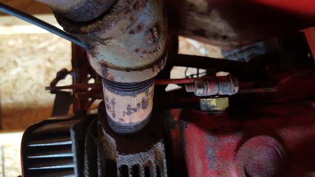

Tlong927 1 #1 Posted September 24, 2015 Ok folks I'm in need of so help. My gt 14 has an exhaust pipe that is threaded into the manifold. I see two holes in the manifold as if there is supposed to be a flange and gasket. Does anyone have a gt14 that they can snap a photo of to show how the exhaust is supposed to be? I'll attach a photo of how mine has been hacked together.Also, has anyone found anything to successfully fix the gas tank leak at the nipple? Thaanks for the help Share this post Link to post Share on other sites
Sparky-(Admin) 25,934 #2 Posted September 24, 2015 I don't think yours is "hacked". Any K series Kohler I have owned has or had the exhaust threaded into the block just like yours.Mike........ 2 Share this post Link to post Share on other sites
KC9KAS 4,746 #3 Posted September 24, 2015 Welcome to Red Square. My GT-14 exhaust Is just like your photo. 1 Share this post Link to post Share on other sites
Tlong927 1 #4 Posted September 24, 2015 (edited) Perfect. Just what I needed to know. I saw the two bolt holes in the head and thought it may have needed a manifold. On a side note. I did the soldering iron trick on the gas tank and it seems to working.Thanks for help guys!!! Edited September 25, 2015 by Tlong927 1 Share this post Link to post Share on other sites
