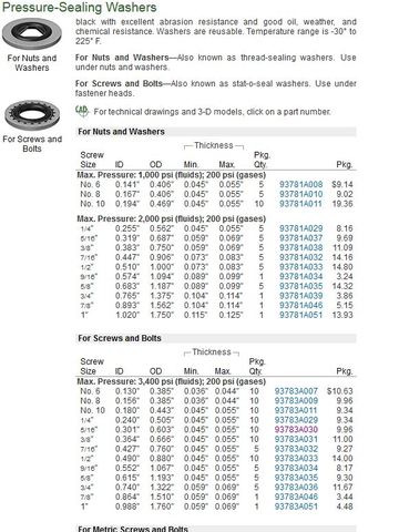

pfrederi 21,274 #3 Posted September 19, 2015 The o rings and backer rings are still available from Toro.Gasket 102759 still available alsoSealer Washer from McMasters or auto parts store a s copper crush washer would also work Share this post Link to post Share on other sites
82Caddy 851 #4 Posted September 19, 2015 Thanks for trying to help guys but I can't find anything on the McMaster website. Must be missing something there. Does anyone one have a link to the 5999 gasket since that's the one I'm worried about leaking and can't seem to locate. Lots of work to get back to that one for replacement. Share this post Link to post Share on other sites
pfrederi 21,274 #5 Posted September 20, 2015 Gasket material and make your own for the case gasket 5999. Do not use silicone. some of it will always ooze out tot eh inside and there are lots of tiny hole in a hydro that it can plug up and cause you many many headaches.Gasket material and sealing washers are available from Mc Master They have the o rings (you have to buy a hundred) but I haven't found the correct backer ones there.or you can use a copper crush washer from your local auto parts store they should also have gasket material . Share this post Link to post Share on other sites
