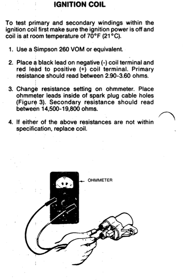

WNYPCRepair 1,924 #2 Posted September 16, 2015 Here is how to test the coil and ignition module from the SM http://www.wheelhorseforum.com/files/file/6-engine-onan-p216-p218-p220-p240-sm-492-4006pdf/ 2 Share this post Link to post Share on other sites
Hodge71 691 #3 Posted September 16, 2015 So we're pretty sure it's the coil. Both ohm readings are way off. Appears to be original. So next question.... It's says there's 2 different party numbers 1, for points and 1 for solid state ignitions. Do these have point hiding somewhere I don't know? It's a 1996 tractor with the original engine.... Sent from my iPhone using Tapatalk Share this post Link to post Share on other sites

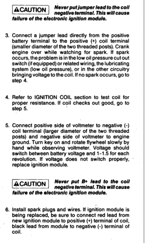

Hodge71 691 #8 Posted September 22, 2015 (edited) So new coil is good. No fire in the hole yet. Really getting frustrated with this. I hate throwing parts at something until there's success. Tested the pick up trigger (ignition module) or whatever it's called like they say in the book. Key on, turn engine slowly check for change from 1.5 to battery voltage. Well it never gets to either. Stays at .876 vdc no matter how many times I turn it over by hand. Is it bad? I really don't want to spend $300 for this part for it not to be the problem. Another interesting thing, turn the key on, spark at the plug, turn it off, spark at the plug. Crank the engine, no spark at the plug but 12 volts at the coil... What is going on with this piece of junk? I should have built a Kohler.... Sent from my iPhone using Tapatalk Oh and another thing. When sitting on the tractor and cranking, the relay on the left pulls in and out as you turn the key on. The relay on the right doesn't pull in. I've swapped them side to side and the result is the same so I would say the relays are good. Sent from my iPhone using Tapatalk Edited September 23, 2015 by Hodge71 Share this post Link to post Share on other sites
cleat 8,986 #9 Posted September 23, 2015 Sounds like a bad ignition module but make sure before spending the money on a new one. Share this post Link to post Share on other sites
Hodge71 691 #10 Posted September 23, 2015 And how do I do that? I followed the test procedure and it never switched from 1.5 volts to battery voltage. I stated that in the above post. It stays steady at .876 vdc so how do I prove this module bad before I spend $300 for it and it's not the problem? Sent from my iPhone using Tapatalk Share this post Link to post Share on other sites
Theroundhousernr 590 #11 Posted September 23, 2015 http://www.wheelhorseforum.com/topic/38044-onan-ignition-module-testing-off-the-engine/ Here ya go. The onan module is essentially a hall effect sensor and can be used to trigger a light bulb on and off. I like to test both right away. Sometimes cheaper meters really can not test the lower ohm readings of a coil. This will eliminate all other issues and tell you if it is functioning or not. Might as well replace your condenser while you are at it. Share this post Link to post Share on other sites
