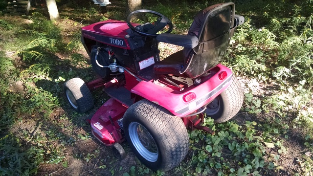

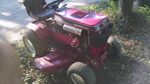

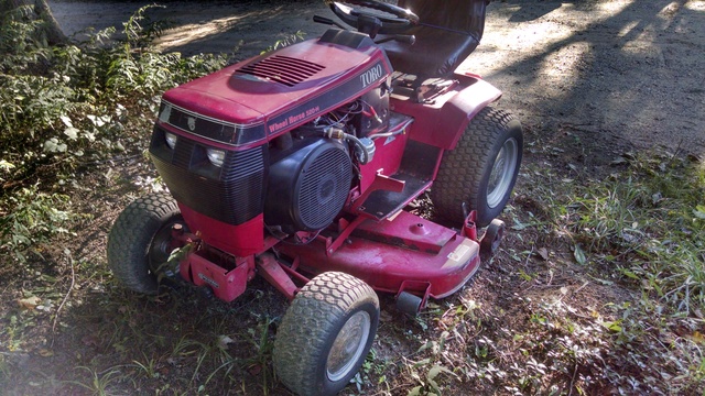

Jake Kuhn 1,600 #1 Posted September 16, 2015 Hi all, This sure seems like a strange post to me but I did end up joining the 520 club! My local show was last weekend and had a guy approach me wanting to sell his. We agreed on a pretty reasonable price and both walked away happy. I have not looked up the year on this one yet but it must be pretty new with the toro decals on it. It has 630 hrs on it which didn't seem too bad to me considering my c175 has 900 now and is still doing great. It needs a little bit of work but nothing major. All the guages except tach work, however it does not want to stay running he has an electric fuel pump on it but it does not want to work right so I will be on the hunt for a correct pump or a kit to repair the one on it(if that can be done) I also am planning to reset the valves and decarbon heads like everyone says too because I definitely don't want to get stuck with the valve seat issue. It should be a good worker and is most likely going to replace the c175 for now. 18 Share this post Link to post Share on other sites

JackC 619 #8 Posted September 16, 2015 With a C175 and a 520H you now have two of the finest big twin cylinder engine machines from Wheel Horse. Looks like a huge electric fuel pump on the 520H.A simple vacuum pump of any brand will work as well as another electric pump. Share this post Link to post Share on other sites

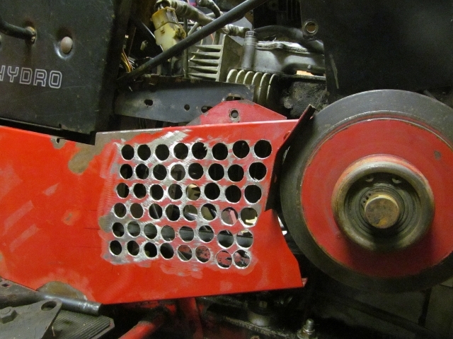

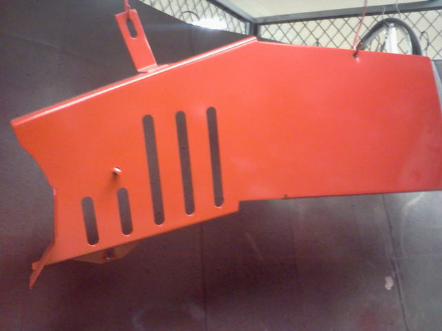

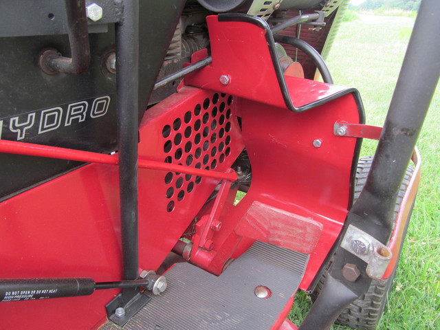

Sparky-(Admin) 26,688 #10 Posted September 16, 2015 As well as valve adjusting and decarboning you might want to consider venting the drive belt guard where the rear cylinder is, get some better air flow in that area.Nice find and good luck!Mike....... Share this post Link to post Share on other sites
WNYPCRepair 1,924 #11 Posted September 16, 2015 (edited) As well as valve adjusting and decarboning you might want to consider venting the drive belt guard where the rear cylinder is, get some better air flow in that area.Nice find and good luck!Mike....... Have you done this? I am curious to see how and where on the guard it is done. Edit - found a picture. Like this? Edited September 16, 2015 by WNYPCRepair Share this post Link to post Share on other sites
WNYPCRepair 1,924 #12 Posted September 16, 2015 Or this one: http://www.wheelhorseforum.com/topic/48134-520h-snow-blower-project-wfoot-control/ Share this post Link to post Share on other sites
Ed Kennell 47,818 #13 Posted September 16, 2015 I drilled mine Brian, then made a housing to collect the heat and pump it into the cab. Cab stays ~ 30F warmer than outside temp. 9 Share this post Link to post Share on other sites

Jake Kuhn 1,600 #16 Posted September 16, 2015 Thanks all, I may look into the belt guard idea but not sure if I will need to do that for only running it an hr or less at a time. Definitely a great idea though. It does have a very large fuel pump and I'm guessing thats the issue is being too big because it will start up and run for about 2 mins and then die and not want to start again until later. It still has the original on it, but I'm pretty sure if they put this one on its most likely no good. lol Another issue I am now noticing that I got it to run for a few mins is it has no reverse, was not told this by the past owner who said the last time he used it everything worked just a couple weeks ago. It goes fine forward and the mower deck lifts right up so I'm guessing there's an adjustment rather than a bad pump, so if there is has anyone done it with any advice? Thanks, Jake Share this post Link to post Share on other sites

Theroundhousernr 589 #19 Posted September 16, 2015 Jake , The hydro lever on the column needs to be pushed down in the neutral position in order to be pulled into reverse. Sometimes that "cam" piece gets pretty worn out making it difficult to get into reverse. Lubrication can help but not solve. Share this post Link to post Share on other sites

cheesegrader 436 #22 Posted September 17, 2015 Jake,Nice buy. 90-93 520. I agree with the vent in the drive belt guard. a huge amount of heat comes off the rear cylinder when the vent is in.I'm not sure I would want it all back in my cab in winter.The adjustment info is in the eaton 1100 manual. You have to jack up the rear wheels, and make a few simple adjustments to get the proper proportion of forward and reverse travel. If you plan to convert it to foot control, you will have to make all those adjustments anyway.I would also replace all the slotted screws in the cover plates between your legs. They strip waaaaaay too often.Before you spend a ton of time on the fuel pump, check the shut-off valve at your tank, and the little screen in there that can clog. Also consider replacing all the fuel lines, as they break down after 20 years, and throw off debris that clogs the fuel system.You will learn all the little quirks quickly. Once you have it running smooth, you will love it. Share this post Link to post Share on other sites

Jake Kuhn 1,600 #24 Posted September 19, 2015 Thanks guys, Still sorting out some issues on the 520. The reverse issue was just me not pushing down on the lever, made me feel a little dumb but glad it was something that simple! Now I am finding out I don't have spark. And maybe thats why it ran and then died before. I was playing with it and sometimes it would have spark for a second and then quit. Now I really have no spark at all on occasion it will spark a very little spark. I have checked the coil and it is good as I ran it on my c175 yesterday. However I do now notice it has a kohler coil rather than the onan one. What else is there to check? I know I am getting power to the coil but not getting spark. Is it possible the igntion module went bad? Or could this be a condensor issue? I've been told that condensors are usuallly just good or bad but maybe thats wrong. Any advice anybody has to give me I would really appreciate it. Thanks, Jake 1 Share this post Link to post Share on other sites
cheesegrader 436 #25 Posted September 20, 2015 Intermittent electrical problems always lead me to check the fuses and fuse block first.That fuse block is a weak point, and has been removed and replace on two of my machines--the two most reliable ones.Second place to look before you spend big money on a coil or ignition module is the 9-pin connector.The 520 electrical gremlins have come to visit!Amazing how often the problems are just corroded connections. 3 Share this post Link to post Share on other sites
