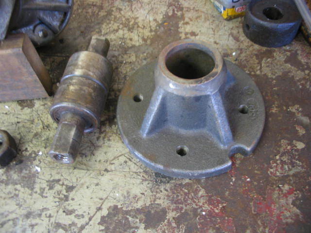

73auto10mo 0 #1 Posted September 15, 2015 Hey everybody, Try to replace the shaft on my center spindle, but can't figure out how to get it apart. I can't find any snap ring, pins or anything holding it together. I have tried to press it apart but that isn't working either. Can someone enlighten me to what I am doing wrong. I believe it cam off of a 36" or 42" deck. It has a barrel with bearings at the ends and the shaft is running through middle of course. Right now I have it sitting in my press with pressure on it and oil sitting in the top trying to get it to loosen up so it will come out. Any help is greatly appreciated. Share this post Link to post Share on other sites

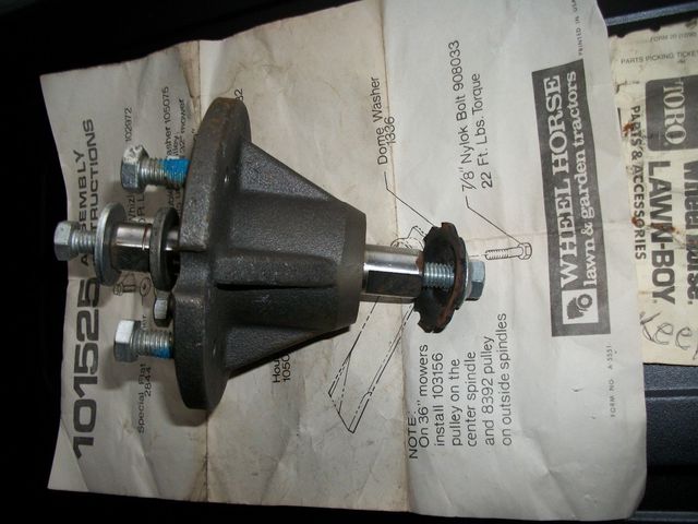

daveoman1966 3,884 #7 Posted September 15, 2015 (edited) The spindle for older 36" decks uses a PRESS FIT bearing # 103119 and it can be a BEAST to remove. I always stand it on a 2" metal pipe and WHACK it HARD with a BFH. ...sometimes repeatedly. It only comes out one way...drive it out from the BLADE end.It looks like this one: Edited September 15, 2015 by daveoman1966 Share this post Link to post Share on other sites

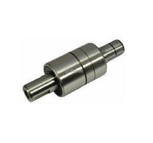

73auto10mo 0 #9 Posted September 16, 2015 The assembly that daveoman1966 posted is exactly what I have. I got the spindle out of the hub but can't get the shaft and bearings out of the sleeve part. I have it in a 20 ton press now with pressure on it and oil sitting on top of it so that maybe it will break loose. If anybody does have a new assembly (yeah right) I would gladly buy it. Share this post Link to post Share on other sites
slammer302 2,157 #10 Posted September 16, 2015 The bearing does not come apart you have to buy the whole thing new its a sealed bearing type Sent from my XT1080 using Tapatalk I believe daveoman is selling one Sent from my XT1080 using Tapatalk Share this post Link to post Share on other sites
